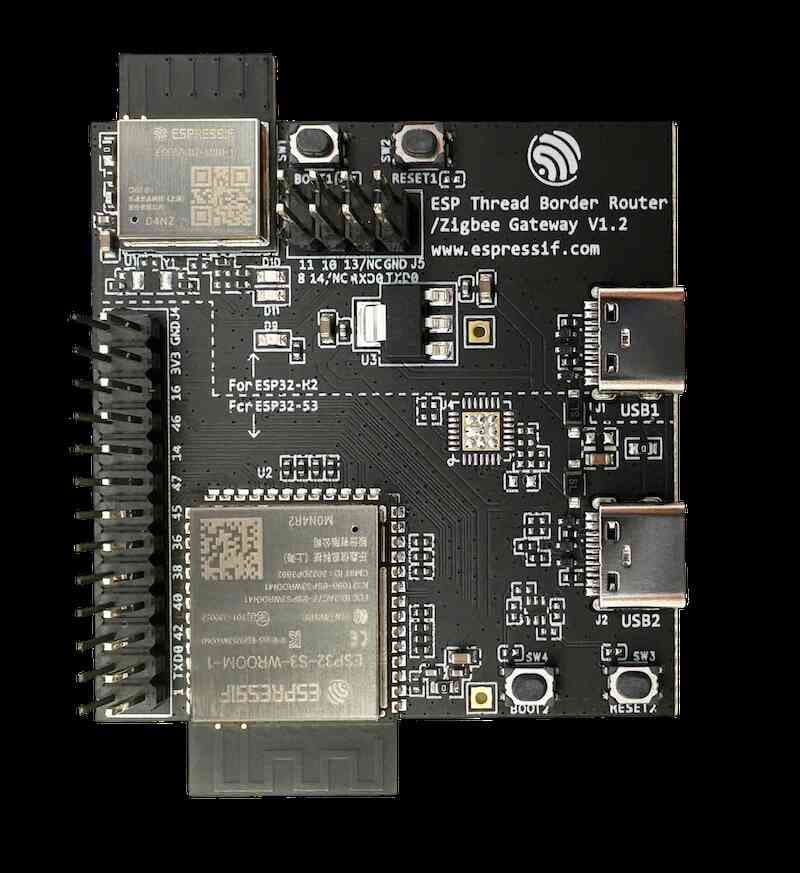

Does ESPHome plan to support the Espressif ESP Thread Border Router Board (ESP32-S3 host + ESP32-H2 RCP) as a ready-made, flashable image or predefined project?
Its a very cheap affordable board.
Right now Espressif only provides build-from-source instructions (esp-idf + esp-thread-br, dual firmware, menuconfig, etc.). It works, but it’s quite complex for a fixed, single-purpose board.

That’s a board.
ESPHome supports both S3 and H2, but how to flash and what to flash is basically out of their scope…
