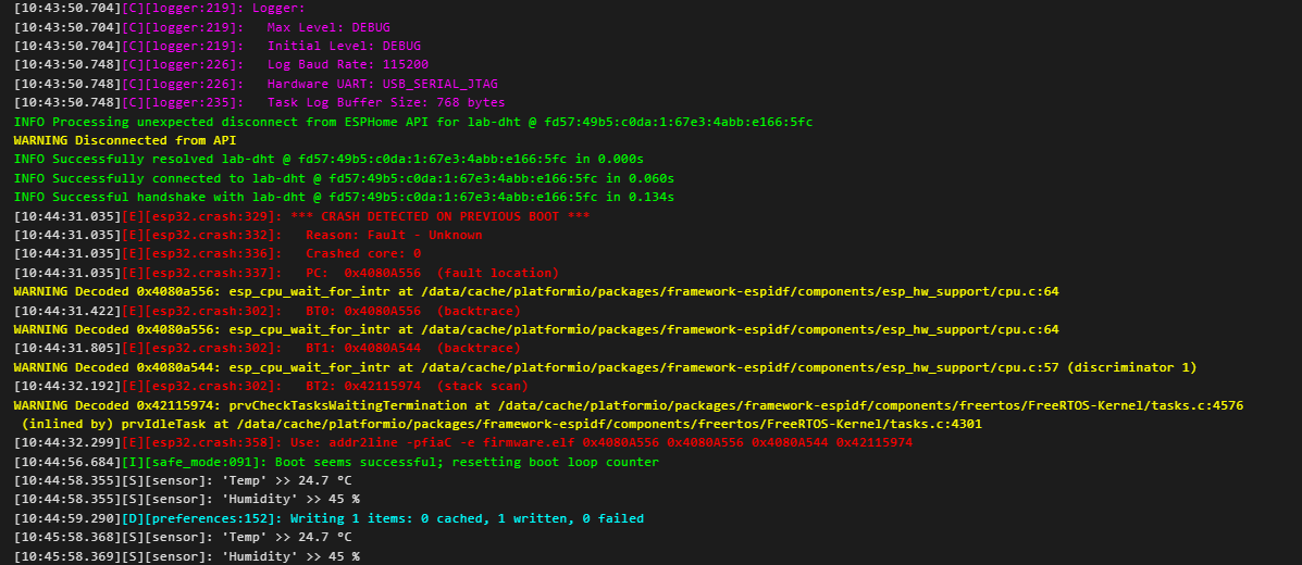

The thread connection (and/or the ipv6 connection) seems very slow. OTA functions take forever, and also I regularly see errors like these:
Or this (note I did NOT just reboot it myself, it did it on its own after I connected to the log):

I looked briefly and didn't see a native MOT for esphome. It doesn't matter (pun accidental) really what protocol so long as they connect and work. And It is working, the only two things that look wrong is how very, very, very long an OTA flash takes, and that I get all sorts of errors in the log. It never (yet) goes unavailable.
