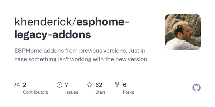

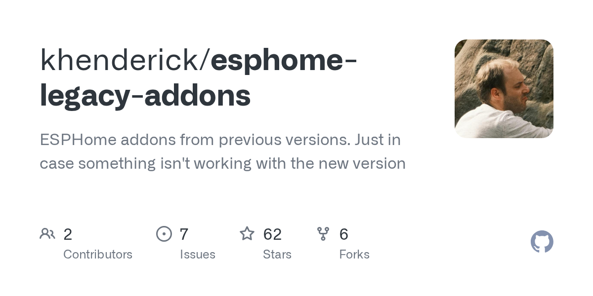

I use this to read and write to UART.
Legacy ESPHome versions repository
