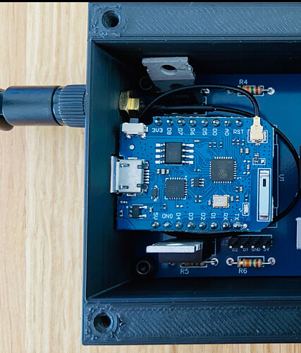

Hi !
Wanted to update my esp home device from 2025.4.0 → 2025.6.0
Unfortunately I get this error during build process:

Well, since you wisely socketed the module, just buy some Wemos D1 Mini modules with 4Mb of flash. They are so cheap I buy them 5 at a time on Ali. Problem solved.
It might could be it is an D1_Mini_Pro…
At least it has an external antenna and as far as I know only the pro has this.
But I have configured this in esp Home:
esp8266:
board: d1_mini_lite
#board: d1_mini_pro
I‘m not sure and I can’t remember why I changed to lite Board…
Is there an option to find out how much flash memory the device has ?
I bought this one:
https://www.makershop.de/plattformen/d1-mini/d1-mini-pro/
So I think it is a pro but with 1Mb why I changed to lite board.
After compile I get this in log window:
RAM:   [=====     ]  46.0% (used 37648 bytes from 81920 bytes)
Flash: [======    ]  60.2% (used 616557 bytes from 1023984 bytes)
So I it should be 1Mb (1023984 bytes = 1.02Mb)…
Or how I can find out how much memory is really available ?
