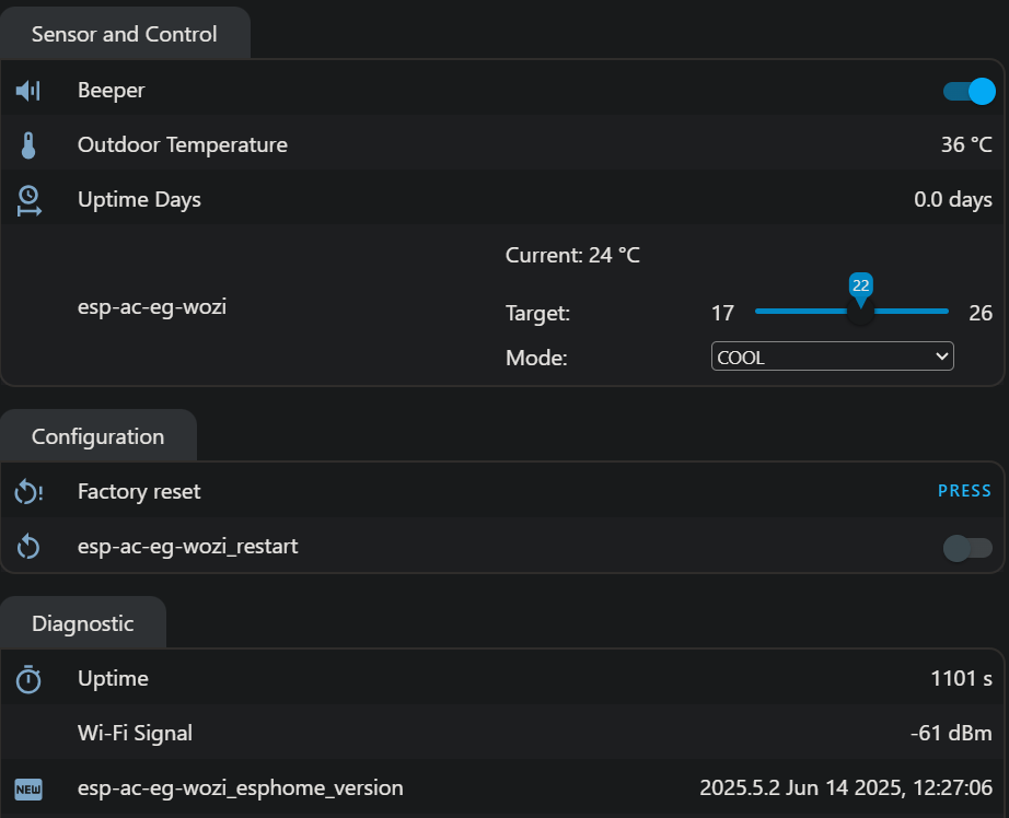

But Sometimes i would like to use the build in ESPhome Webserver.
But i dont have all options there.
With HA i can control:
Beep, Target Temp, mode, fan mode, presets an swing mode.
But on the WebServer the only options i have are:
Beep, Mode and Target Temp
Why cant i control the Swing Mode or the presets?
i’ve tried different things i found here and in the wiki.
local: true or inculde_internal
but nothing changed.
Can someone help me?

Possibly that’s all the web server supports. Maybe one of the s would know.
You could create some dummy selects that would use an action to update the Midea climate entities, they would appear on the web server.
