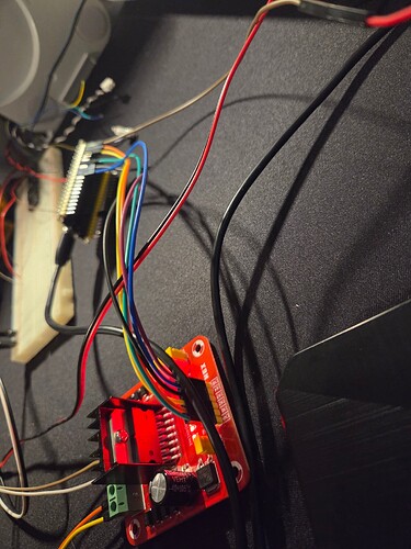

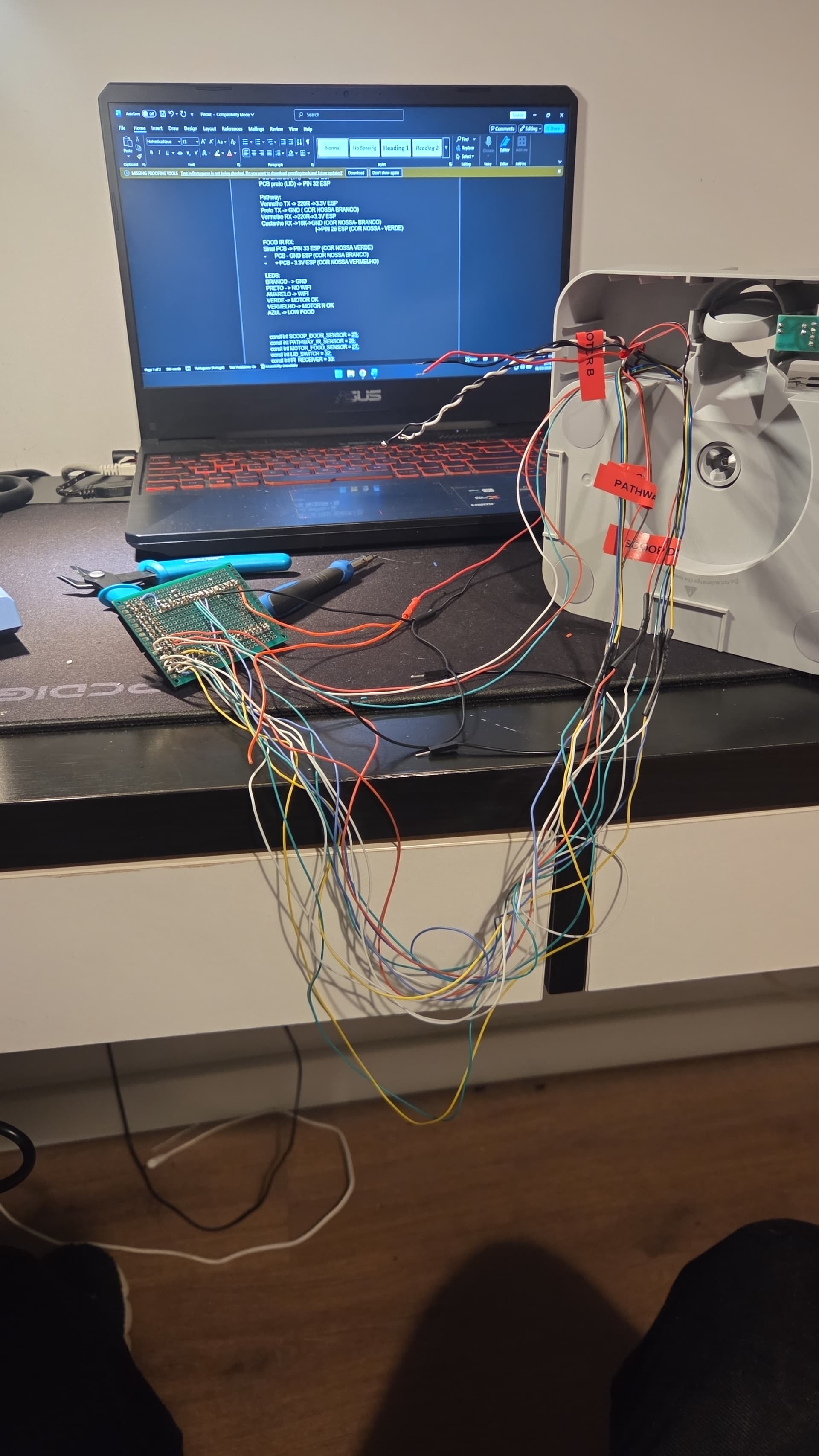

​The Build

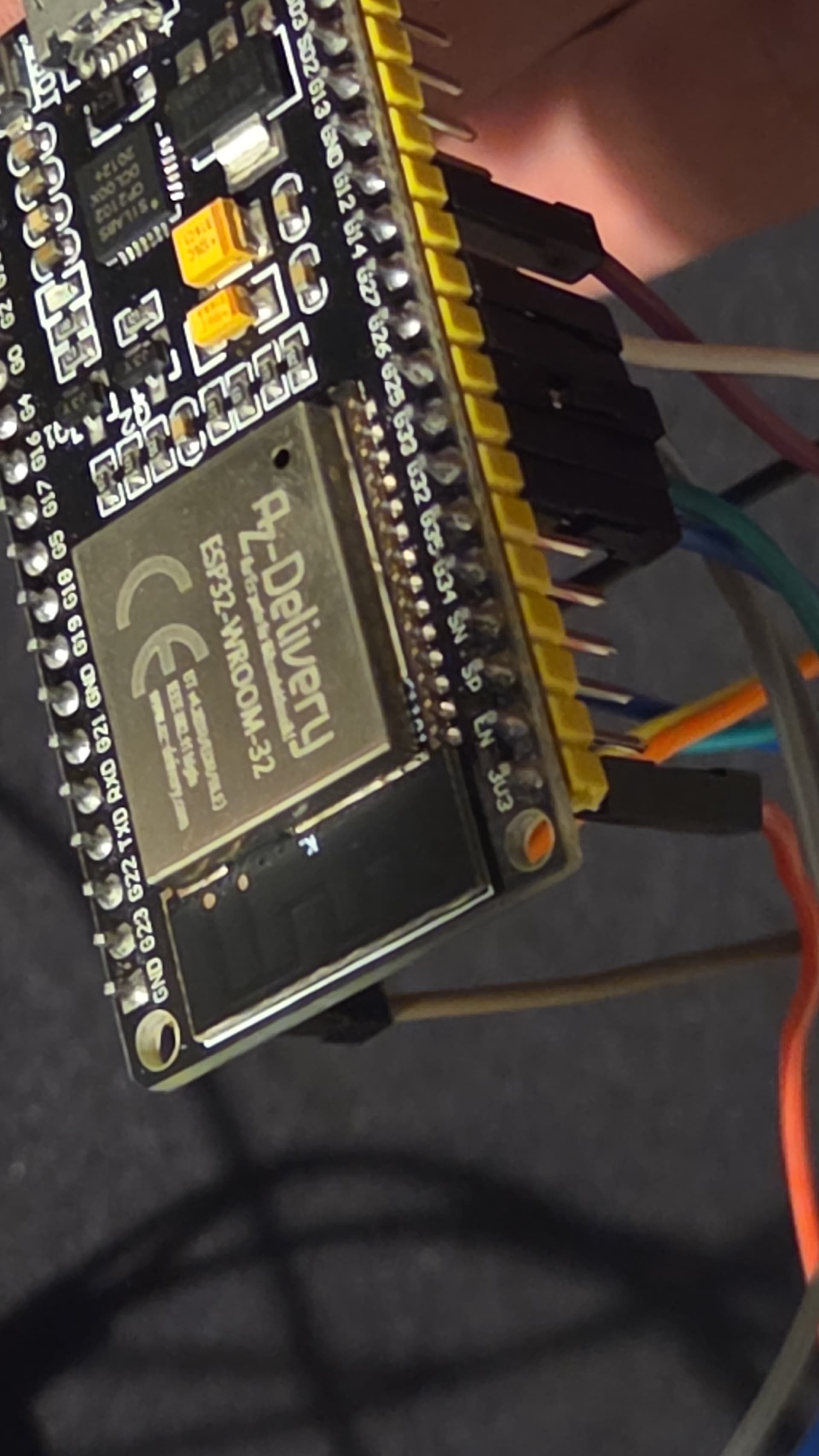

​The project is built using an ESP32 (WROOM32) and a dual DC motor controller. After carefully identifying all the sensors and motors, I started writing and testing the project on a breadboard. It took about a month—mostly because I didn’t have much free time—but I finally managed to solder everything to the board and start writing the final code. I started with Arduino and eventually moved to ESPHome.

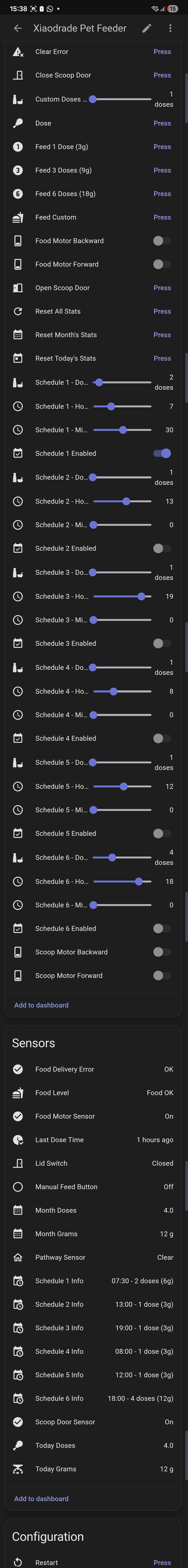

​Currently, everything is running locally on ESPHome with the following features:
​Customized Portions: Tailored to Ari’s diet.
​Scheduled Feedings: Fully automated.
​Tracking: Daily and monthly portion counts (in grams).
​Last Feeding Log: Knowing exactly when he last ate.
​Food Delivery Error: A smart alert that triggers if the motor turns but the output sensor doesn’t detect food.
​Capacity Sensor: Real-time status (Low food / Food OK).

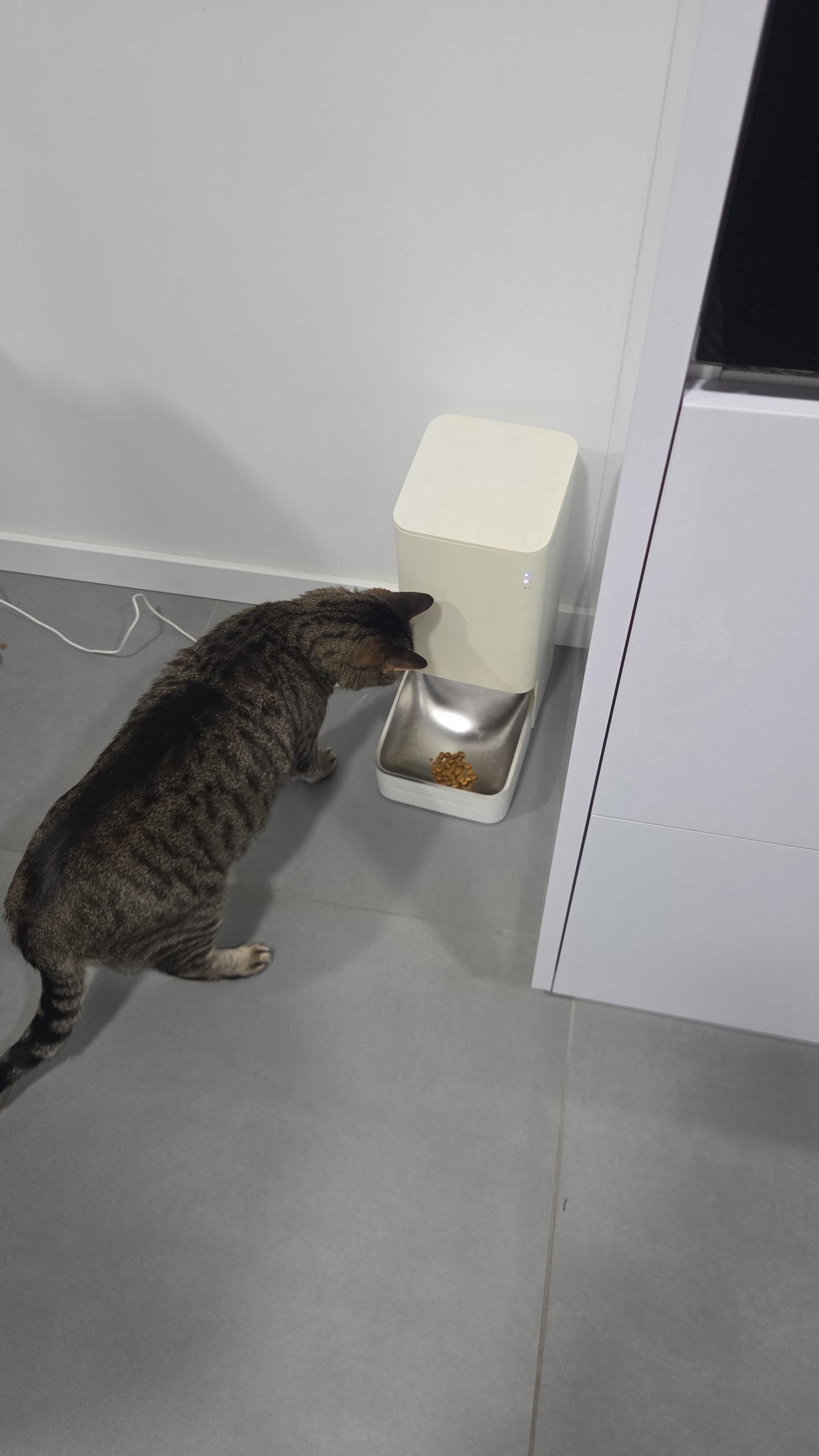

​I also built in several redundant safety systems. If Home Assistant goes down, I can still access the feeder via a web browser. While the schedules usually sync with the Home Assistant clock, the device will pull time from an NTP server if the connection is lost. As a fail-safe, if the router is off, the ESP creates its own Internal Access Point so I can still connect. There is also a physical button on the lid that dispenses food without any connection at all (just power, of course).
​This was a challenging project, especially since I had never done anything like this before—I had never programmed or even touched a breadboard. I managed to pull it off with the help of a great friend João Lima and some assistance from VSCode Copilot.
I added some photos of the process and the final result. Please dont mind my dodgy soldering skills.
​Eat this, Xiaomi.
