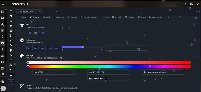

Can anyone share a working example of CWW light control in Esphome for the ESP32-H2 (zigbee) board? My code is below, but I can only control on/off and brightness. There is no color temperature control, but there is color control, but my lamp is not colored.

Solved by replacing the code:
- id: COLOR_CONTROL
          attributes:
            - attribute_id: 0x400a # ColorCapabilities
              type: U16
              value: 0b0000000000010000 # Color temperature supported
            - attribute_id: 0x400b # ColorTempPhysicalMinMireds
              type: U16
              value: 153
            - attribute_id: 0x400c # ColorTempPhysicalMaxMireds
              type: U16
              value: 370
            - attribute_id: 0x0008 # ColorMode
              type: U8
              value: 0x02 # ColorTemperatureMireds
            - attribute_id: 0x4001 # EnhancedColorMode
              type: U8
            - attribute_id: 0x0007 # ColorTemperatureMireds
              type: U16
              device: light_cww_temperature_sensor
              scale: 0.333
              on_value:
                then:
                  - light.control:
                      color_temperature: !lambda "return (float)x;"
