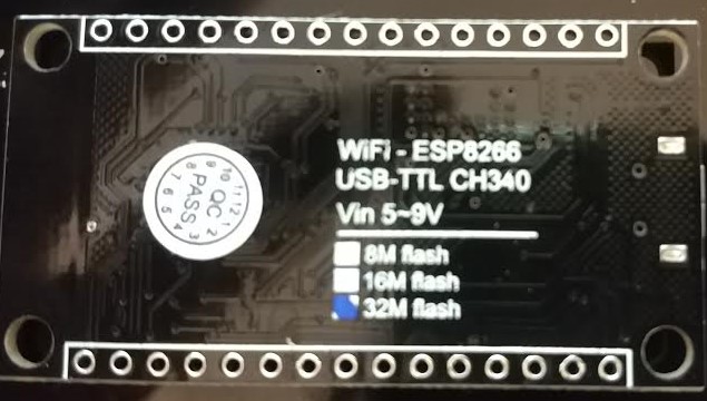

02
^ can someone tell me what chip is this?
http://docs.platformio.org/en/latest/platforms/espressif32.html#boards
http://docs.platformio.org/en/latest/platforms/espressif8266.html#boards
nodemcuv2?
I’d say so
