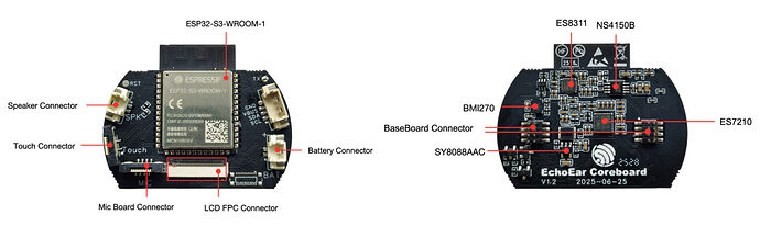

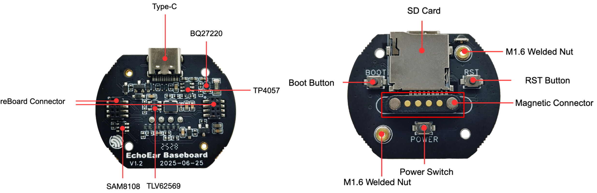

Based on its specification it looks to basically be a development kit built around Espressif’s ESP32-S3-WROOM-1 Wi-Fi 4 and Bluetooth 5 module, however the enclosure design make it seem ready for retail?
Espressif’s EchoEar key features are:
  • ESP32-S3.
  • 2 microphones in an array (Dual LMA3729T381-OY3S microphone array).
  • Built-in 3W mini speaker.
    • NS4150B 3W Class-D amplifier
    • ES7210 audio ADC (4-ch)
    • ES8311 audio codec (ADC + DAC)
  • 1.85-inch circular touch display (ST77916 driver).
  • Bosch BMI270 6-axis IMU Sensor
  • microSD card slot for data storage
  • USB Type-C port for programming, power, and log printing
  • 3.7 V Li-ion battery (connector)
    • BQ27220 battery management chip
    • TP4057 Li-ion charging IC (250 mA charging current)
    • TlV62569 / SY8088AAC buck converters (5 V → 3.3 V)
    • SAM8108 power control chip (power on/off management)
  • magnetic connector for popopins (serial + 5 V) to use UART pass-through docking
    • Internal I2C header

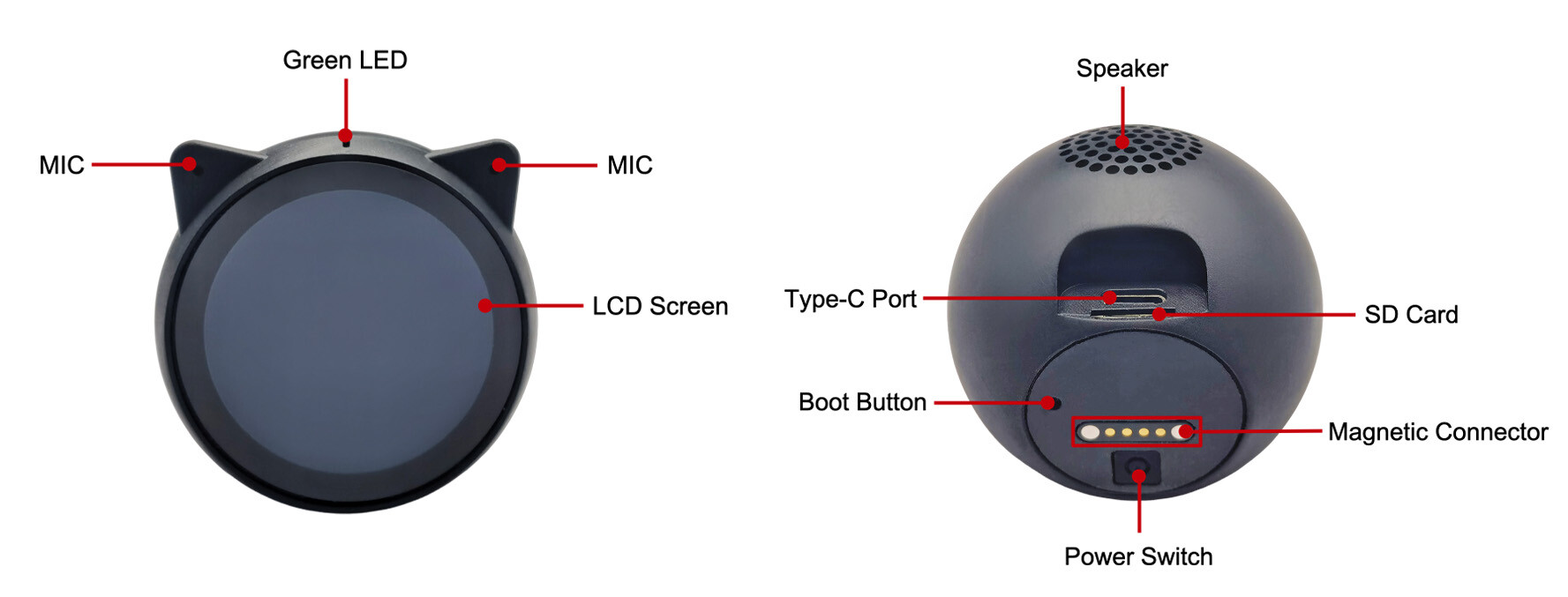

I have this device! Just arrived a few days ago. I think I must have been one of the first to order it when it went live on Espressif’s AliExpress store… :smile:
Happy to answer any questions!
Build quality is good (though there’s a tiny bit of backlight leakage on the bottom of the screen from certain angles, but not a deal-breaker). Speaker is LOUD & good for voice assistant text-to-speech, but obviously :grimacing: for listening to music.

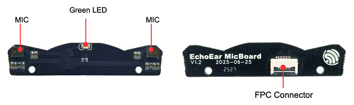

It’s cute, and I really like the placement of the mics in the cat ears.
