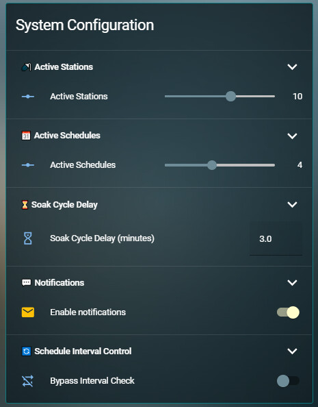

The system is fully configurable through the Home Assistant dashboard. After the initial installation, everyday changes such as station runtimes, GPIO assignments, schedule times and watering days do not require editing YAML, restarting Home Assistant or reflashing the ESP32.

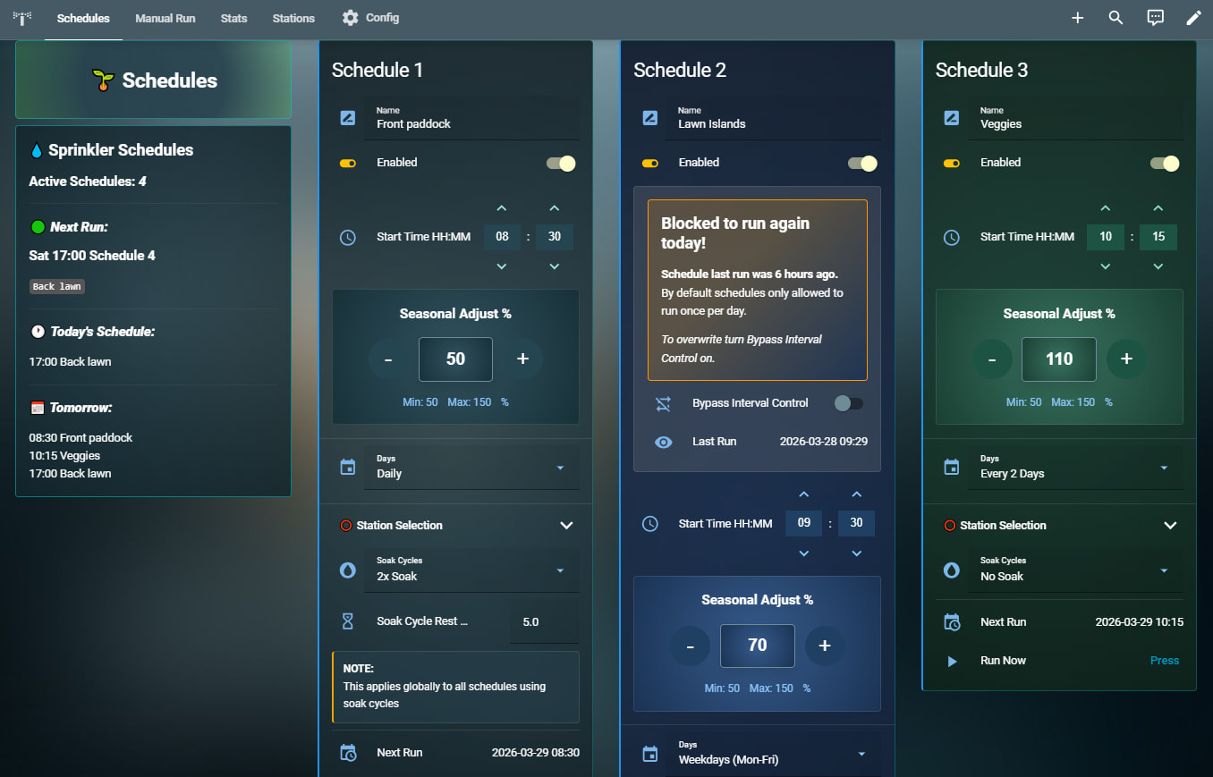

  • Up to 8 independently configurable schedules

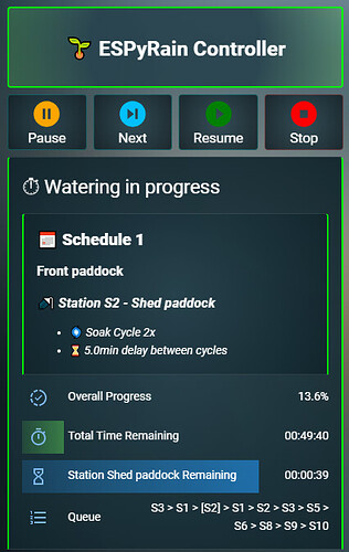

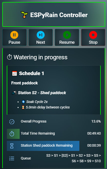

  • Queue-based execution for overlapping schedules

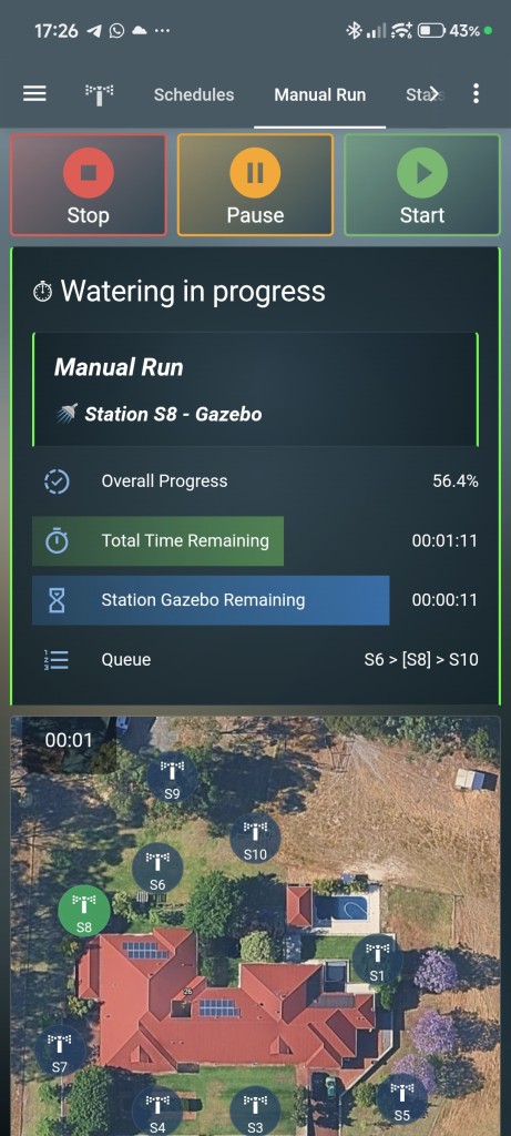

  • Manual and scheduled runs
  • Start, stop, pause, resume and next-station controls

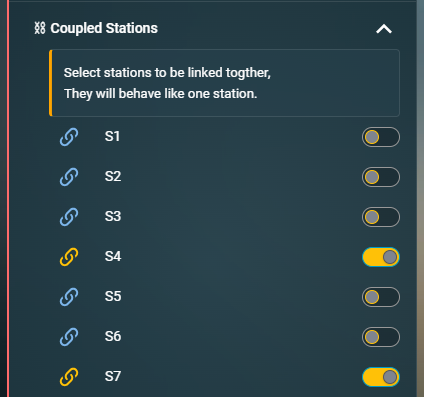

  • Coupled stations that can operate together

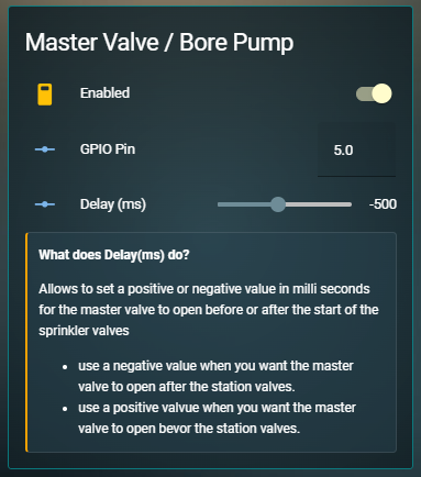

  • Bore pump or master-valve support
  • Configurable pump/master-valve timing
  • Seasonal runtime adjustment from 50% to 150%

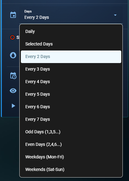

  • Daily, selected-day, weekday, weekend, odd/even and interval schedules
  • Soak cycles with configurable rest periods

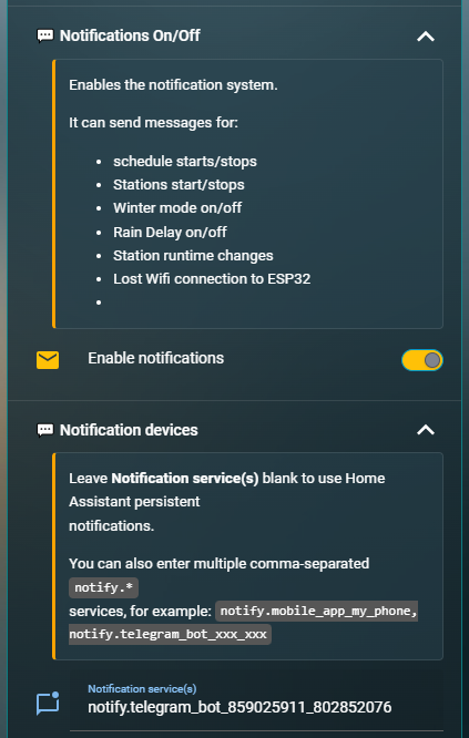

  • Home Assistant notifications

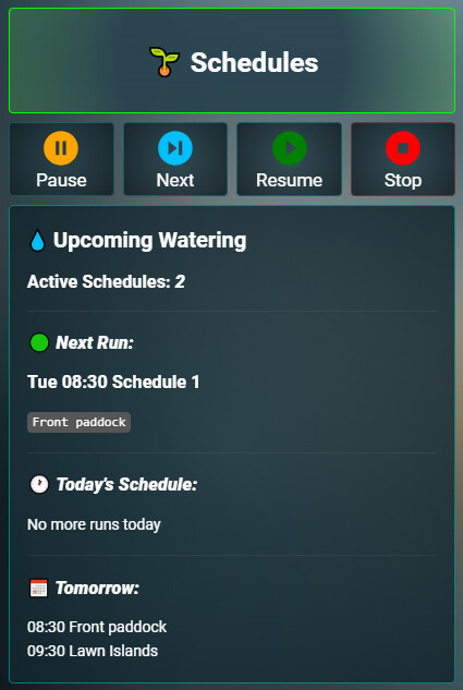

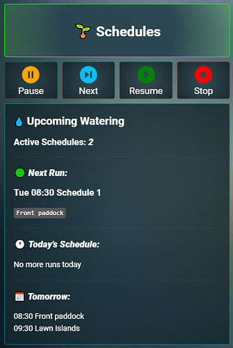

  • Seven-day watering forecast and upcoming-run information

  • Controller status, queue progress and diagnostic information

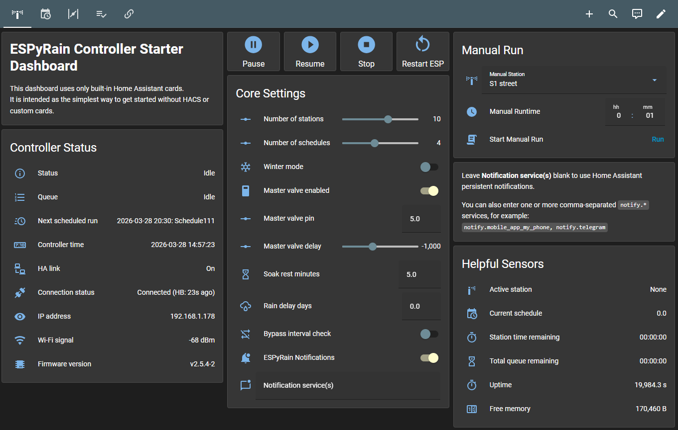

Two Home Assistant dashboards are included:
  • A simple dashboard using standard Home Assistant cards
  • A more complete dashboard with richer controls, graphics and status information
The simple dashboard provides an easier installation path without requiring HACS custom cards. The full dashboard includes additional presentation and control features.

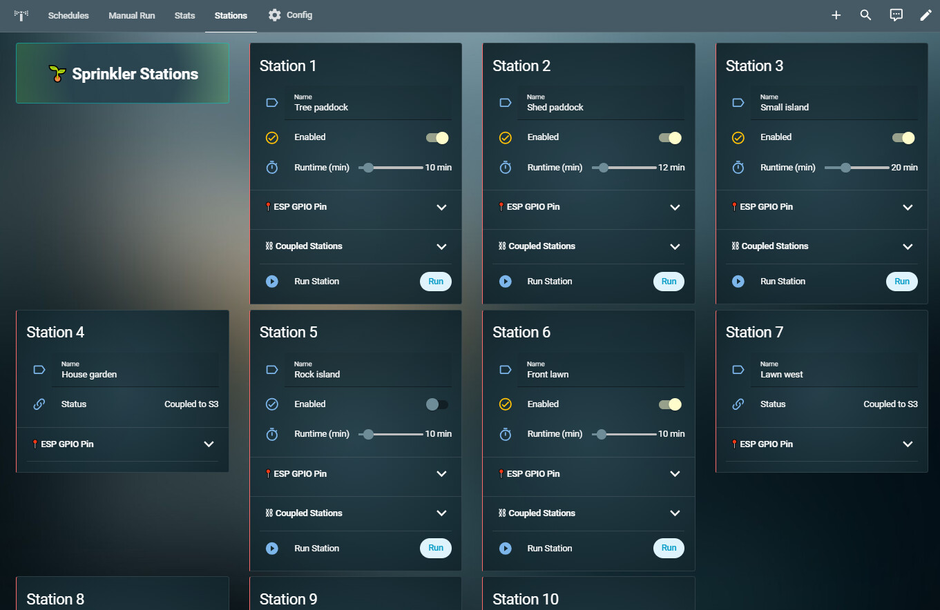

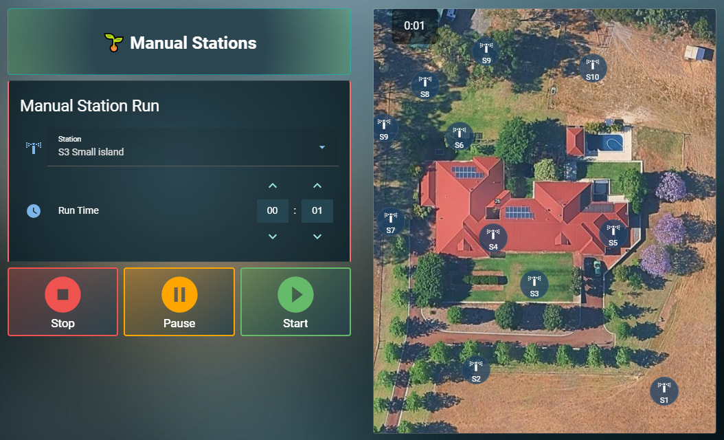

Full dashboard - Schedules
Simple dashboard

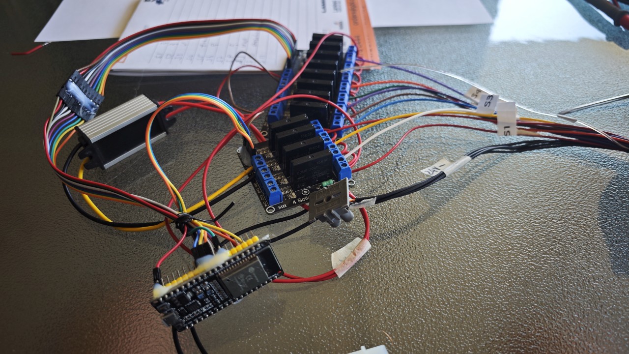

  • Suitable relay or output hardware for your valves
  • Basic familiarity with Home Assistant, ESPHome and safe irrigation wiring

Some ESPyRain screenshots

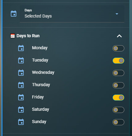

Sprinkler day selection
Very nice!
Have a question about scheduler. The municipality I live in puts restrictions on which days of the week that the irrigation system can run. They essentially have a schedule Monday..Sunday with Monday=0, Tue=1,…,Sun=6. If you live on an street with an odd address you water on odd days (1,3,5), and if you live on a street with an even address you water on even days (2,4,6) (so no one can water on Mon=0). Does this match with any of the “Selected Days” in the scheduler you show in the screenshot above?
It is very flexible, you can use any of the pre-made selections like weekdays, odd, even… or use “Selected Days” and you can select exactly the days you are allowed to run your sprinklers.
