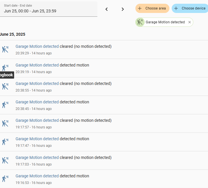

can you share the history of respective sensor? I am curious if the sensor goes on for 10 (random) number and goes back off afterwards or it stays like on state while door is open.
PS: I do not own a sensor rather I am the developer of custom integration.

I am asking the history of binary sensor (Voordeur Sensor open)
