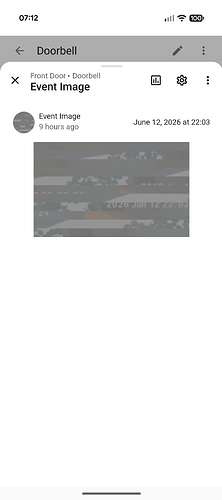

My doorbell T8210 produces only these images in HA, in the eufy app the quality is good. Any hint? Something Todo with encryption? I'm sure i disabled it but can't find the setting in the eufy app.
eufy introduces some more encryption. For some days, not a single picture appears. The integration devs changed already some things, but the images are still broken. Just have an eye on the integration repo.
