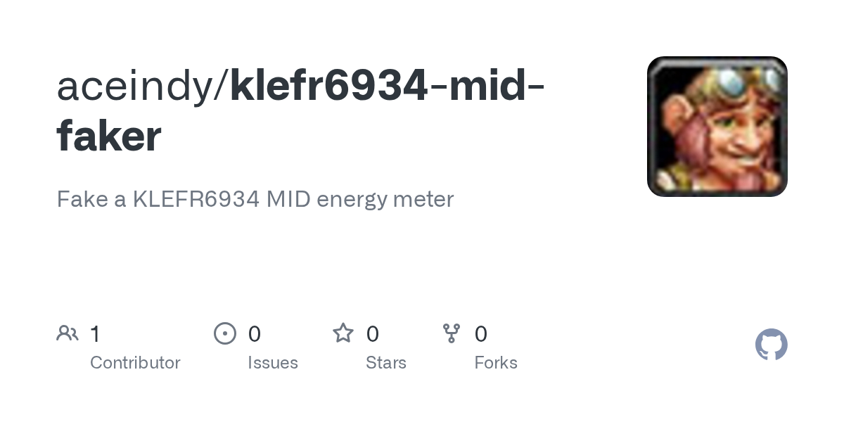

I recently bought a Technivolt 101 as it was very cheap.
But i miss interpreted the info i found on internet; it did not come with the mod interface i was hoping for; it required a MID power meter to interface with.
So i ended up adding an esp32 module, faking a MID meter, allowing me to manipulate the data as i see fit :grin:
As result i charge my car only when my dynamic energy prices are negatif, or when i have solar surplus :innocent:

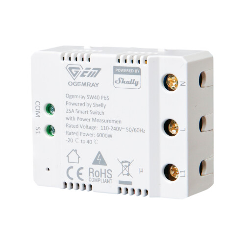

Another option for 240V 16A, is a Shelly 25A relay. Many devices may SAY they can handle high current, but can't. I've not (yet) tested the 25A relay with a 10A EVSE, but that's Monday's job to install for a Type 1 EVSE:

BTW - After fitting a Ogemray SW40 to a 10A EVSE yesterday, all is working, tested, and my friend doesn't need to get up in the night to get cheap energy as the Shelly handles scheduling itself. I did check and test all terminals twice.
