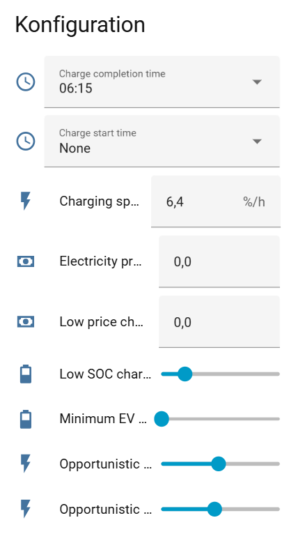

Here are the settings in the device integration:
Any suggestions how to succesfully schedule a charging session based on the lowest price intervals or what’s else causing the issue? I am happy to provide more information if necessary to get this going.
