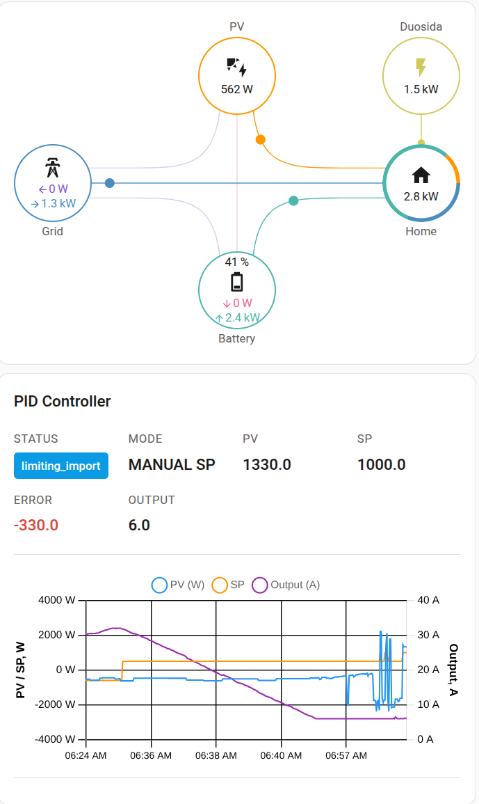

Grid Limiter
The Grid Limiter is a separate safety mechanism.
It is designed to prevent the controller from accidentally increasing EV charging enough to cause excessive grid consumption.
This can happen when:
  • a large household load suddenly turns on;
  • a cloud causes PV production to drop;
  • the battery reaches its discharge limit;
  • the battery becomes fully discharged.
The battery feedback may take some time to reflect these changes while the PID is still trying to maintain its target.
The Grid Limiter monitors grid power and restricts EV charging if grid import exceeds the configured limit.

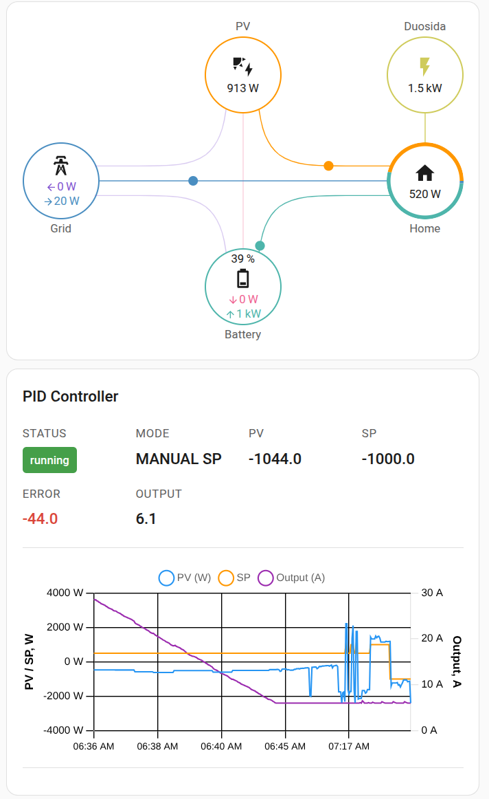

What Home Assistant needs
The integration requires:
  • Battery charge/discharge power — PID feedback
  • EV charger current or power — PID output
  • Grid power — optional Grid Limiter
The PV production sensor is not required for the control loop.
Tested setup
The controller has been tested with:
  • Deye 12 kW hybrid inverter
  • Duosida EV charger
Both are integrated into Home Assistant.
The controller is generic and can work with other equipment as long as Home Assistant provides the required numeric entities.
