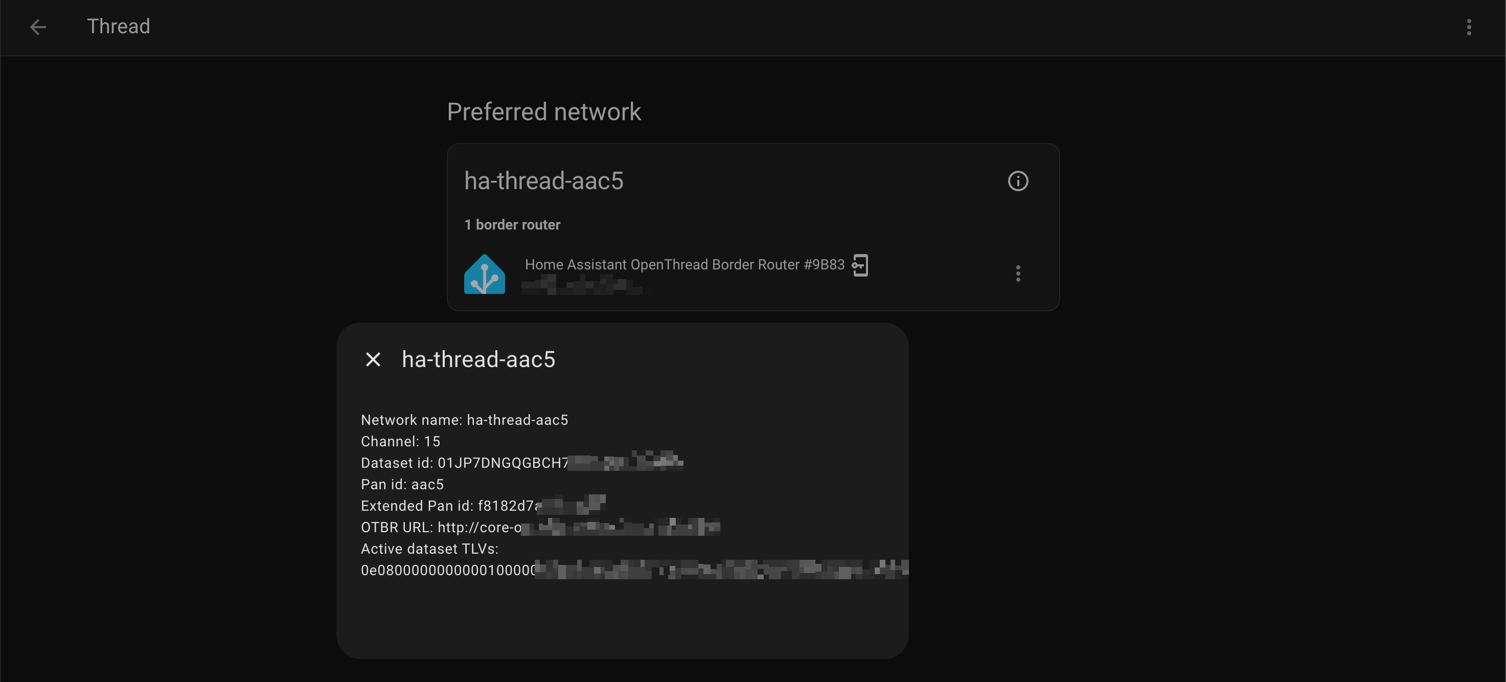

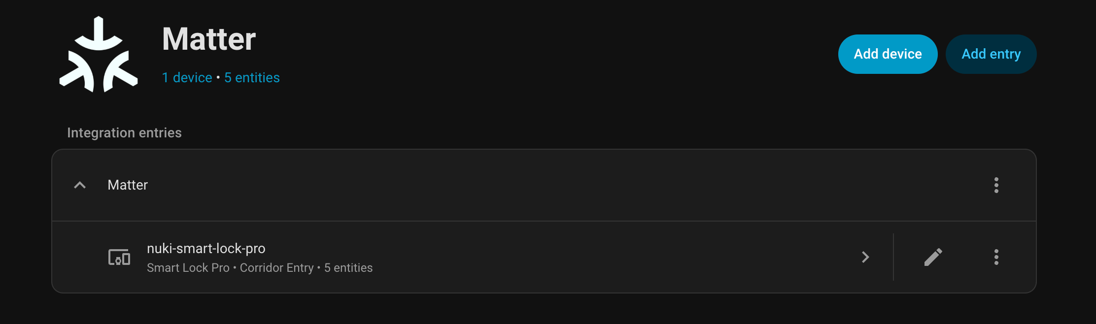

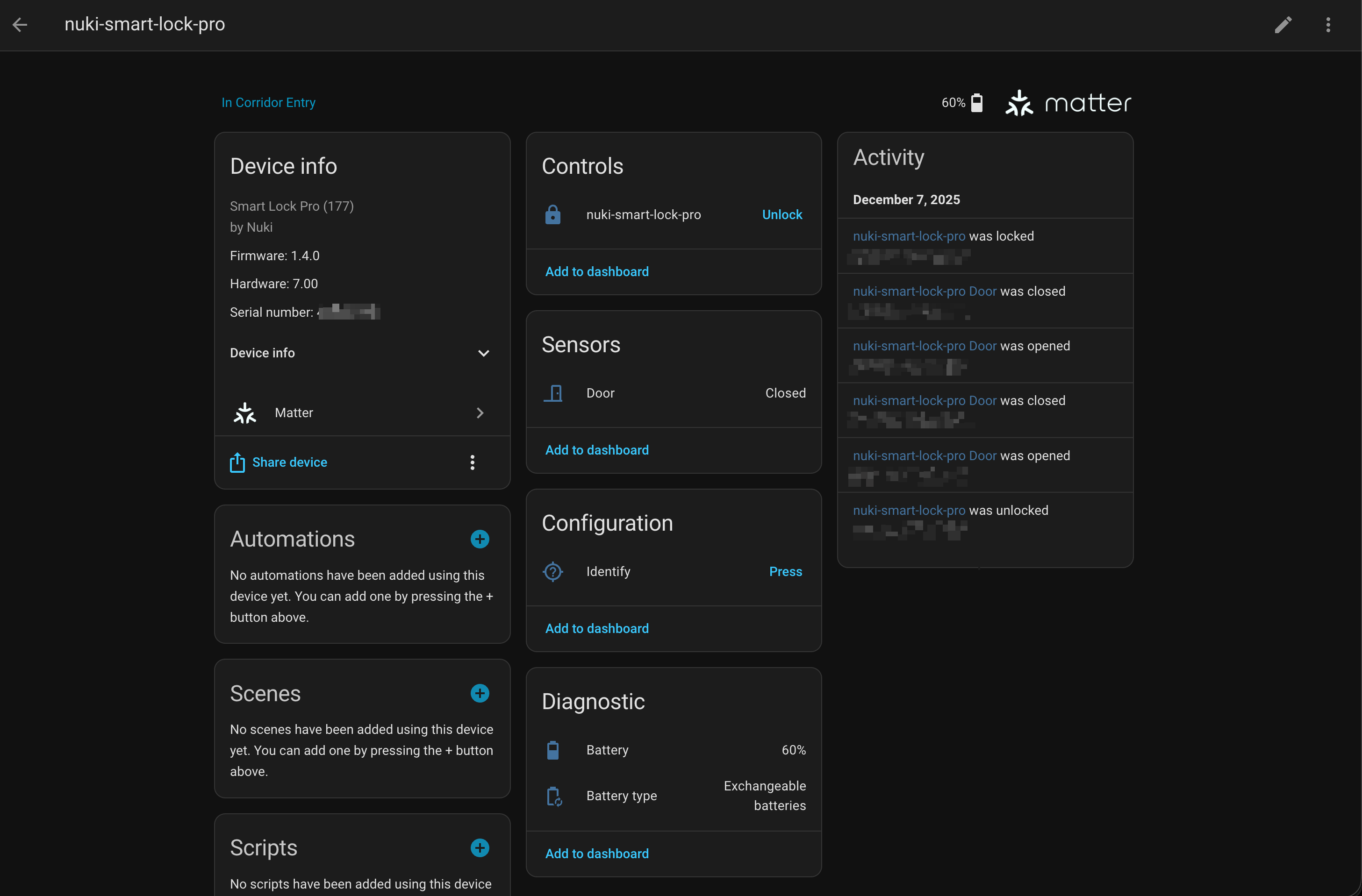

You can see some printscreens of Matter and Thread Border Router here:
Matter Integration:
Matter Nuki Smart Lock Pro:
Thread Border Router:
