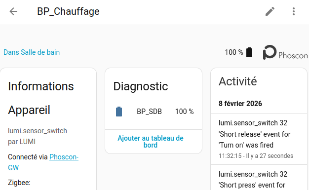

strange behaviour for few days, the switch trigs an event but the automation don’t know about it.
In which direction should I investigate ?

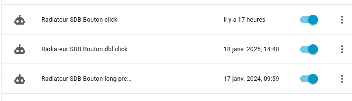

Detail of the automation:

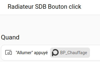

Ok, I dont’ know what was the problem but I found a solution: I edited all my automations using this button: I added a new event to start it with this same button and deleted the old event, and saved it.
It seems there is an identifier that changed for this button.
