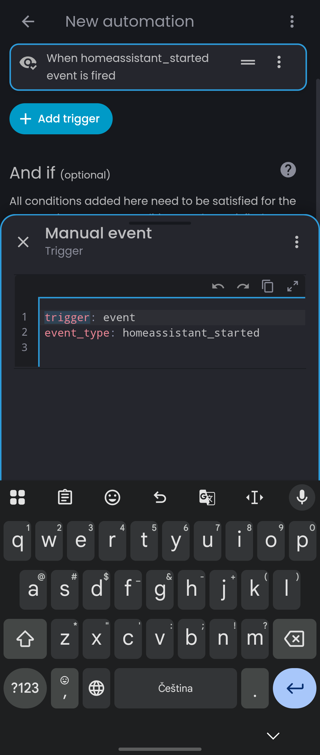

Use manual event as trigger…
I tried this Test-Automation, but it seems that no event was fired:
- id: 'test_ha_started_event'
alias: "TEST: HA Started Event Listener"
mode: single
trigger:
- platform: event
event_type: homeassistant_started
condition: []
action:
- service: persistent_notification.create
title: "Home Assistant started"
message: "homeassistant_started Event received."

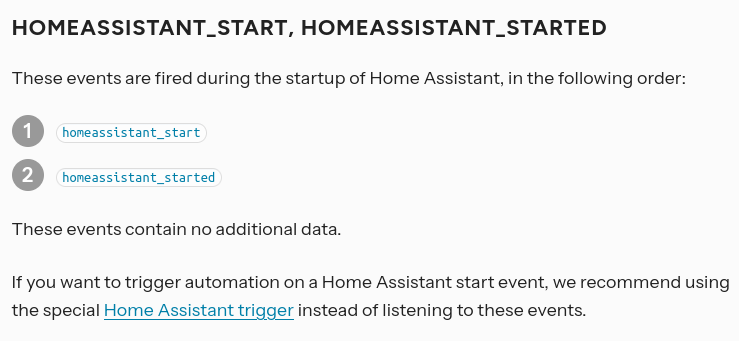

According to this:
especially see screenshot above from Didgeridrew
there are 2 events:
homeassistant_start and homeassistant_started
according to this, homeassistant_start is fired the HA starts, and homeassistant_started should be fired when HA is started completely.
I need the event when HA is started completely in an automation.

Because, according the description here
event “start” is firering at the beginning of the start from HA, and “started” when finished starting.
