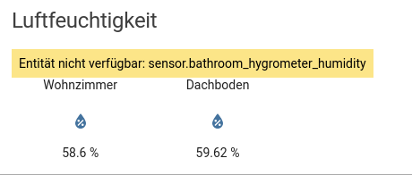

I can see the data of the Mi hygrometer at my master. But everytime i open the frontend I get the warning that the Mi hygrometer entity from the slave is not available:
DeepinBildschirmfoto_Bereich%20ausw%C3%A4hlen_20190310002515
After ~15s, or I guess the time until my master receives the next MQTT update from the slave, it is displayed correctly:
DeepinBildschirmfoto_Bereich%20ausw%C3%A4hlen_20190310002714
Why is there a “Lag” like this? I would assume that Home Assistant saves the last state and can display it when I’m opening the frontend view, since my recorder is activated.
On the other hand the 24h graph is working. So the recorder has the old data of the sensor.
