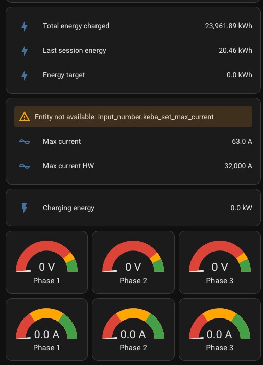

@vic Thank you for your support. I’m new to HA so learning a lot :slight_smile:

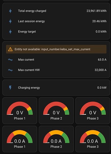

Got your dashboard up-and-running except for 1 error that I still have. Any idea what I’m doing wrong?
that is an input_number that I have created as helper.

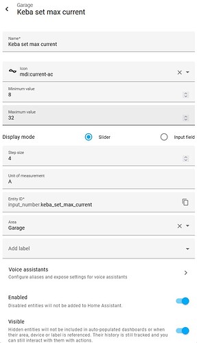

You can go under setting/devices/helpers and create a new input_number as shown here below:
Wonderful!! It works. Thank you :pray:

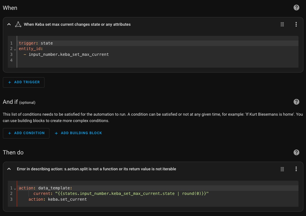

Sorry to come back but…I don’t get it to work. Would you mind to share a screenshot of your automation? Hereby mine that is not working
Hi Kurt,
which error(s) are you getting?
Can you share the code of your automation?
You can get the code going on the 3 dots inside the automation and pressing “Edit in YAML”.
The effect should be that when you move the slider “Changing current”, the element “Set max current wallbox” should also change accordingly.
