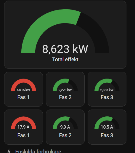

Attached snapshots when boiling water and L1 peaked 18A without any charge limit from EVSE Load Balancer. Is that expected?

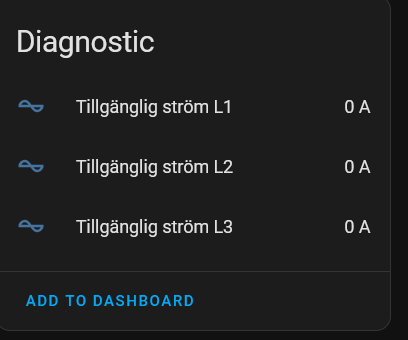

This is house in idle mode (no charging, no boiling etc):
Which fuse sizes did you configure when setting up the integration?
The way how it works it that it will calculate the active current based on your active power and voltage, it will then deduct that from the configured fuse size.
In your case (given it idles at 0) it looks like your fuse size might be configured as 0? In which case it’s deducting your active current (17) from 0, resulting in -17.

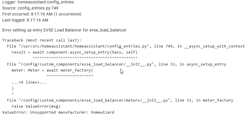

Hey just downloaded the branch and tested but error in adding the integration
Thanks @lsc597! Easiest would be if you create an issue and/or PR in the Github repo so I can assist you there and track progress.

Ah, seems like I indeed missed something. I just pushed a fix which should resolve this issue. Fix missing meter init · dirkgroenen/hass-evse-load-balancer@c8b93ce · GitHub
Hey, tested it and the installation works now.
but it’s difficult to monitor what’s it doing, beause the Diagnostics don’t work:
It’s configured as 16A. I’m not sure if this really works as expected?
So if my house is idling, available A should be 16, not 0?

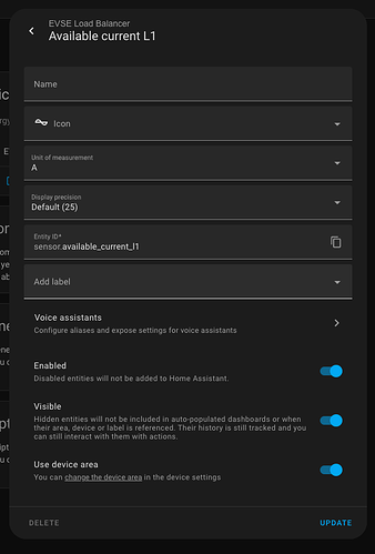

You have to enable the entities, they are disabled by default.

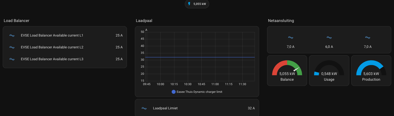

Hmm that’s a bit weird indeed. If your house is idling it should indeed report an availability of 16. See the below, which is my own house (fuse of 25A, right side if current going through meter (positive in this case due to production, left side is EVSE Load Balancer)

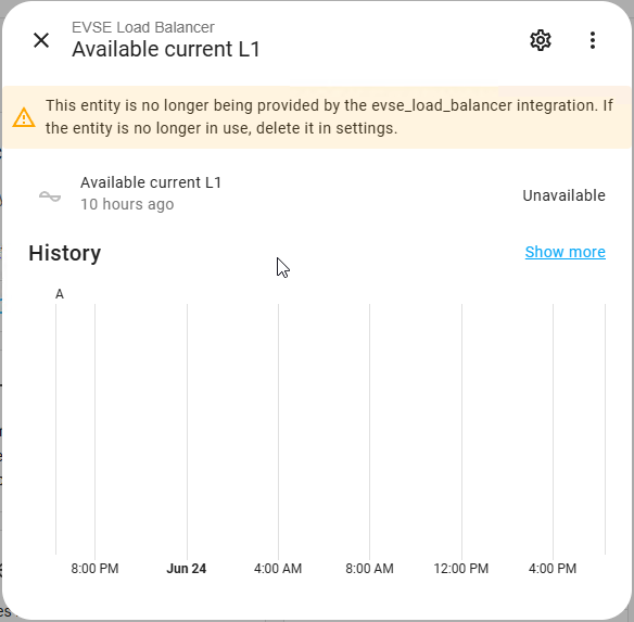

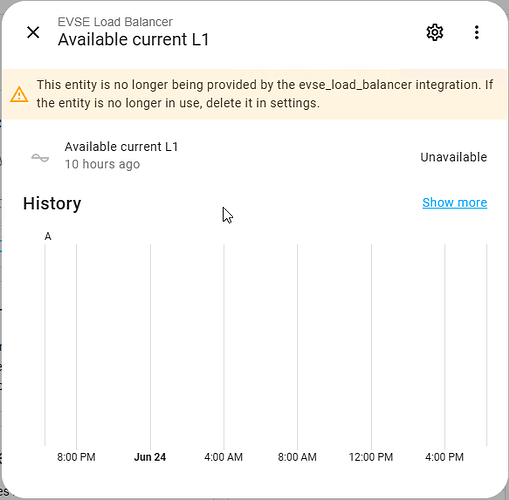

i don’t see any message in the logsbooks, all P1 integration are exposed. But i’m getting this error on the EVSE
i just checked in integration to and i goes immediatly to full power and stays there so it doesn’t work yet completly.
But i don’t know where todo more debugging?
It’s according to the message no longer being provided by the integration, which makes me assume it’s disabled or something else is going on. You can try:
