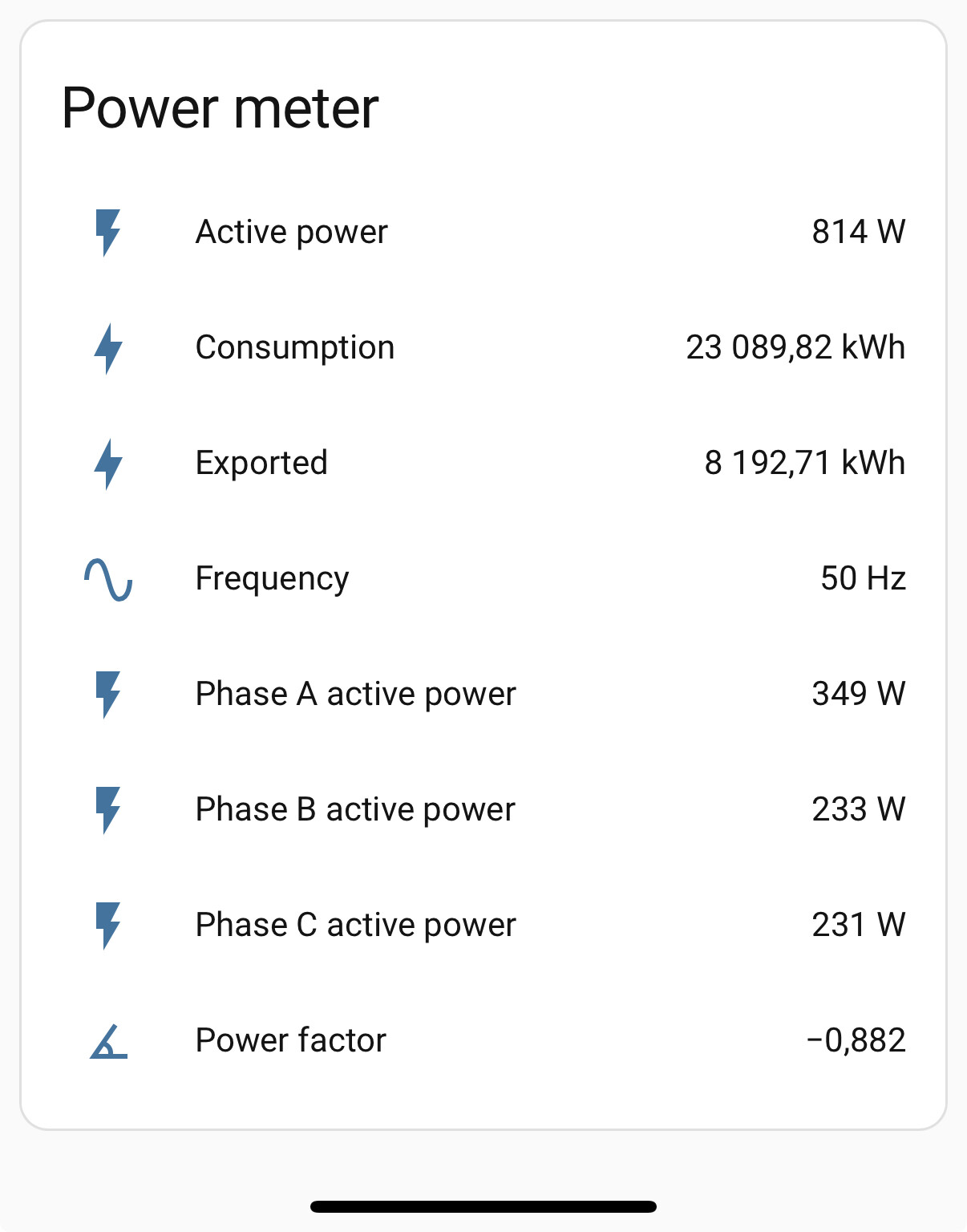

Also metering, again it would be good to have it as an entity. I have RS485 metering connected directly to my solar but the figures are distributed via an entity value to a number of other templates and devices.

As for the metering: I think this should already be the case, depending a bit on your exact use case. When selecting the “meter” there’s also the option to provide “advanced options”, which allow you to provide any entity as long as it represents a power state class. (I use this personally for manual testing as well)

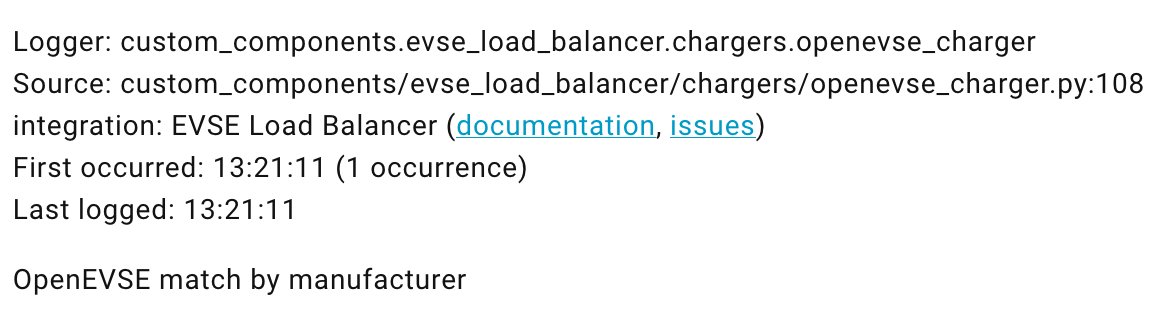

hi @dirkgroenen I’ve tried your project and did my best to see if I could make it work with GitHub - firstof9/openevse: OpenEVSE Integration for Home Assistant
I have an OpenEVSE charger (one of the few which are real open hardware).
Unfortunately I think I am stuck to the best of my capacity. I was wondering if you are interested to see if this platform could be supported too!

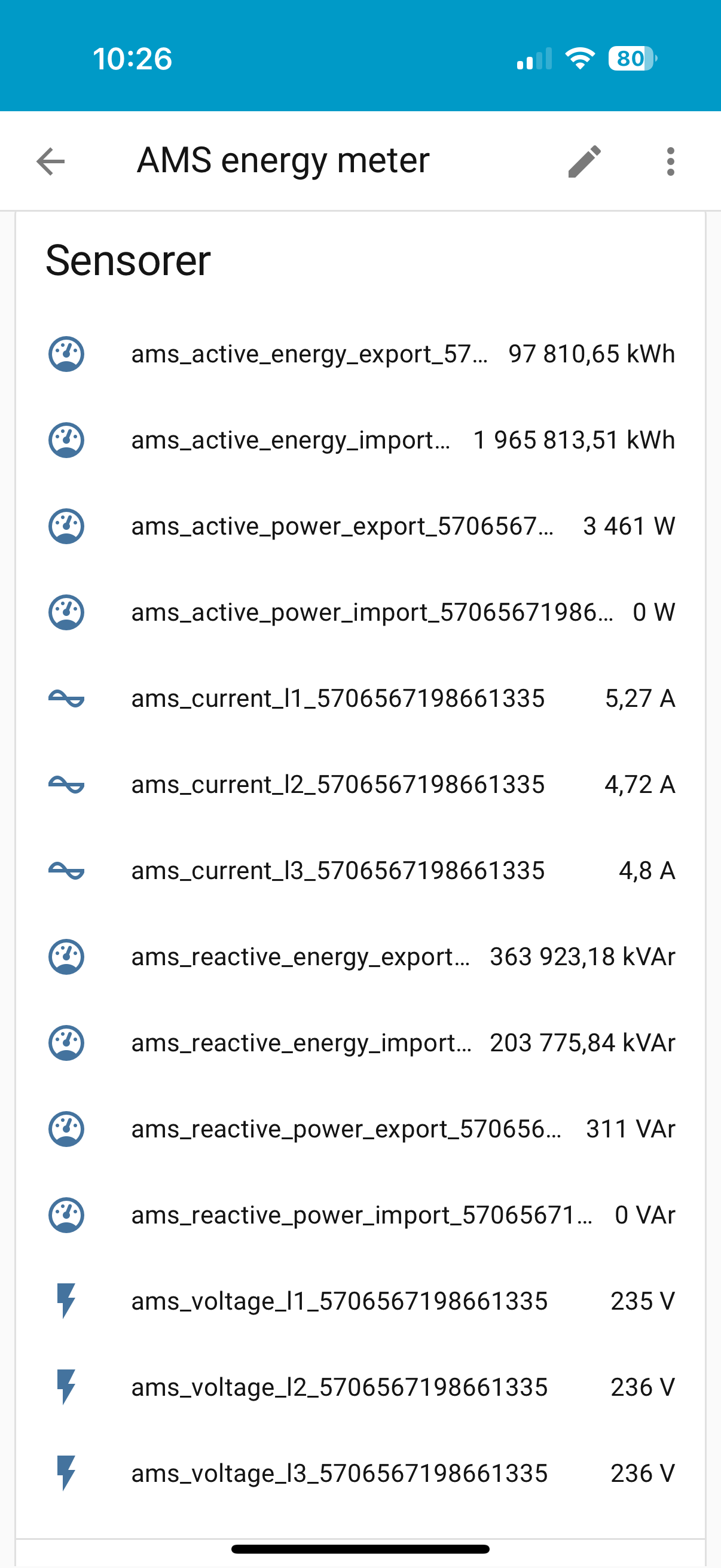

No, I use this one, hass-AMS-reader.
It’s a HACS integration. I read values from the HAN-port into a M-BUS → Serial converter ->HA.
Got a lot of sensors.

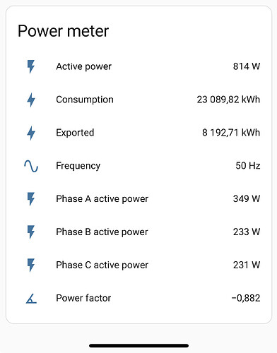

Problem I think we have we this meter, as well as some others, is that there’s no distinctive power measurement per phase which indicates if we’re consuming or producing power. That might require some additional work to get things going.
Sweet. I tried the custom meter option but the problem is that I can’t get a voltage by phase sensor, since EVSE don’t pick hass-AMS-reader, and by that I assume the integration will get a hard time calulating the current. I have another power meter ,that came with the PV, and that one presents active power by phase. (+) values when exporting and (-) while importing. EVSE-load-balanser reads this one but the problem is that this powermeter don’t have a by phase voltage sensor:-(.
So I’m stuck :slight_smile:
//Fredrik

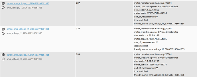

Not sure if I get what you’re saying here. Are you saying the the integration doesn’t allow you to pick the Voltage Sensors exported by your HASS-AMS-READER integration?
i would expect you to be able to select the three Phase Voltage sensors as shown in your first screenshot. If not, please go to HASS’ “Developer Tools → States” and show me the attributes for those sensors. An example:
With the active power provided by your other sensor you could consider combining the two. Using power from one and voltage from the other (assuming they both have the same’ish intervals on which they output data).

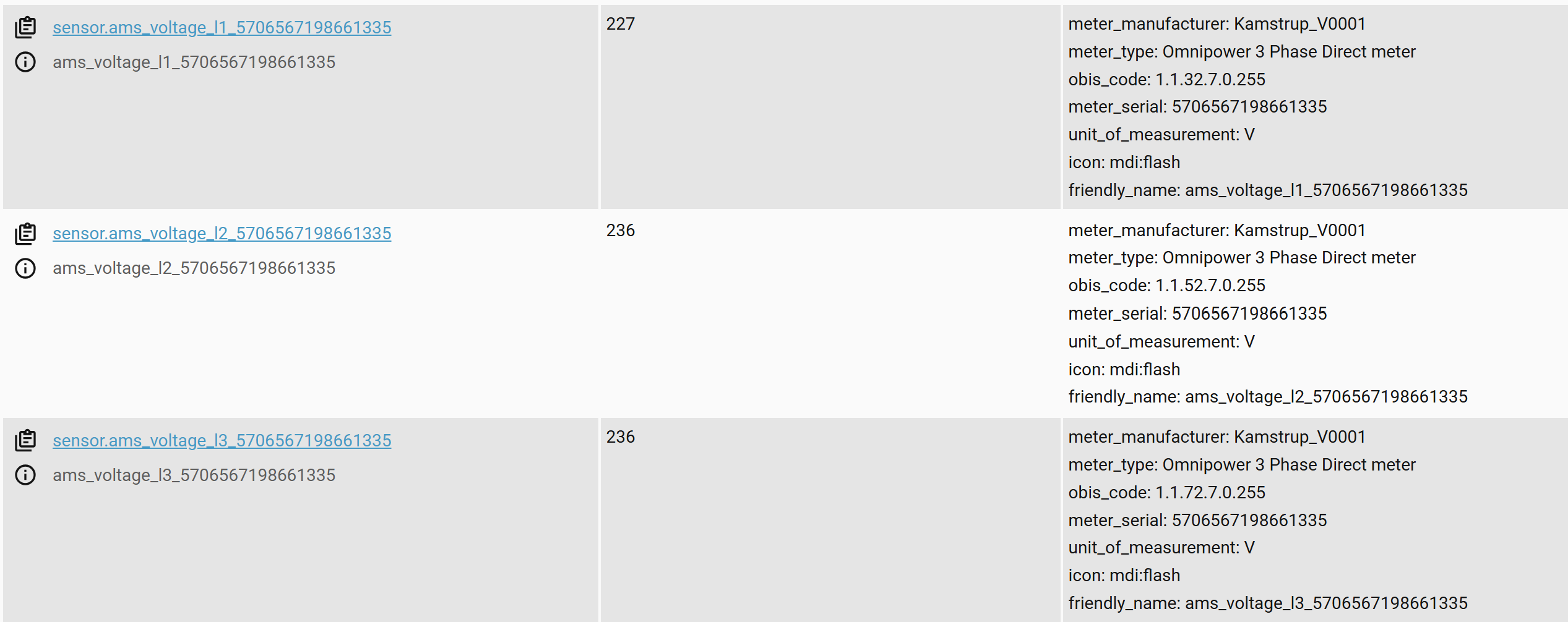

Hi again.
No, the integration dont´t pick the hass-AMS-voltage sensor. Picks up a lot of other voltage sensors but not them.
States like this
Thank you for your efforts :slight_smile:
//Fredrik
s
Your screenshot is actually showing the 3 voltages, one for each phase (Lx).
Using the “Advanced Energy Meter” approach (during setup of the load balancer) you can select these sensors for each phase.
Screenshot below is a single-phase setup, where you’ll need to provide the power consumpion, production and voltage sensors.
The extension expects a separate power consumption and production sensor. Not the most ideal design I’ve realised, but for now we’ll have to work with it.
If you’re sure that your “active power” produces a negative value when it’s consuming power and a positive value you could create HASS Helpers to turn those into separate entities. For example using a “value template” which normalises the values:

Hi.

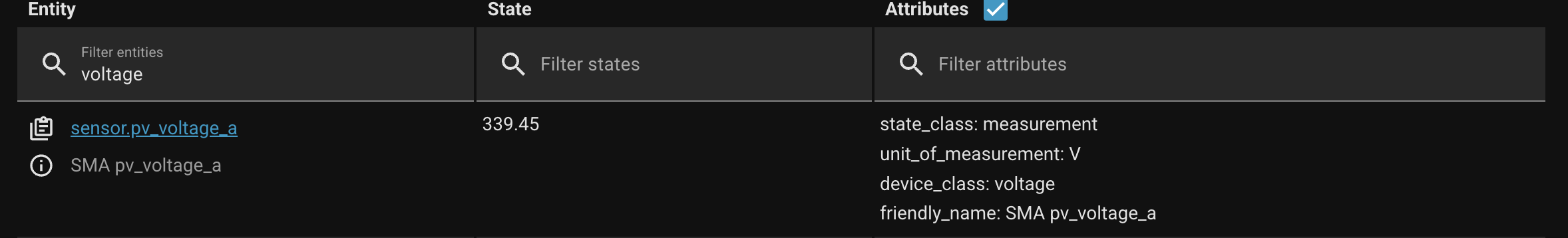

Think I got a solution. The voltage sensors I got lacked device class, and because of that they didn’t show up in the dropdown in the loadbalancer integration. I created helpers for them with device class voltage and now they are visible. Also created helpers for power consumption so I think I’m good to go😁
