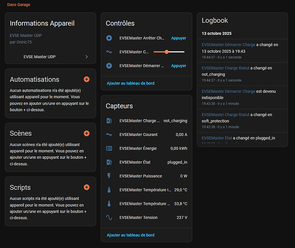

What it provides:
- Explicit Start / Stop charge buttons (no ambiguous toggle)
- Charge status sensor with states:
charging,soft_protection,not_charging - Sensors: current (A), voltage (V), power (W), cumulative energy (kWh), internal / external temperatures, meta operating state (idle / charging / plugged / offline / error)
- Configurable maximum current (amps) setting
- Optional soft protection delay between stop → new start to reduce mechanical relay wear
