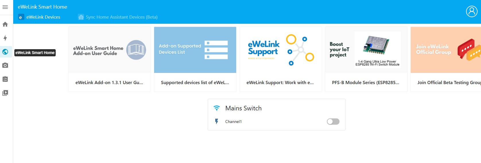

The only wifi controllable changeover switch I can find is Ewelink controlled.
Does anyone know if there is an integration for these switches yet?
Yes, I know there is and I have the Sonoff integration, but I can’t figure out if it’s compatible with the ATS. It’s important to me to have this controlled locally, not in the cloud.

I have a smart transfer switch and it has limited HA integration of an on or off switch. To do scheduling you do need the phone app.
