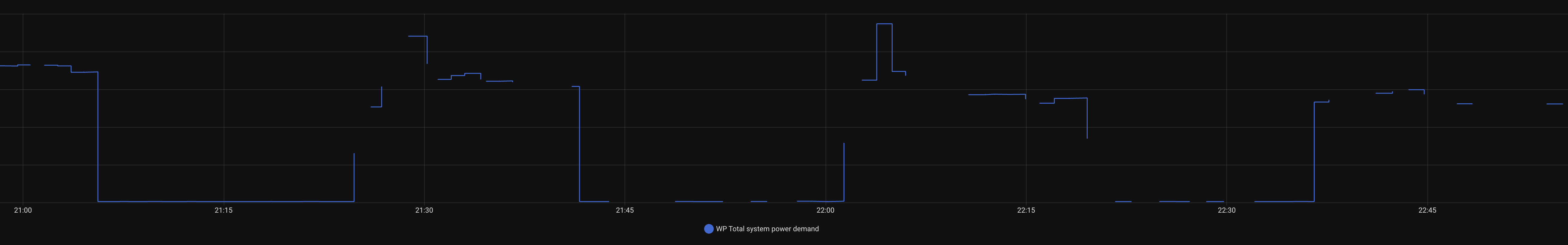

here how it is looks like before update:

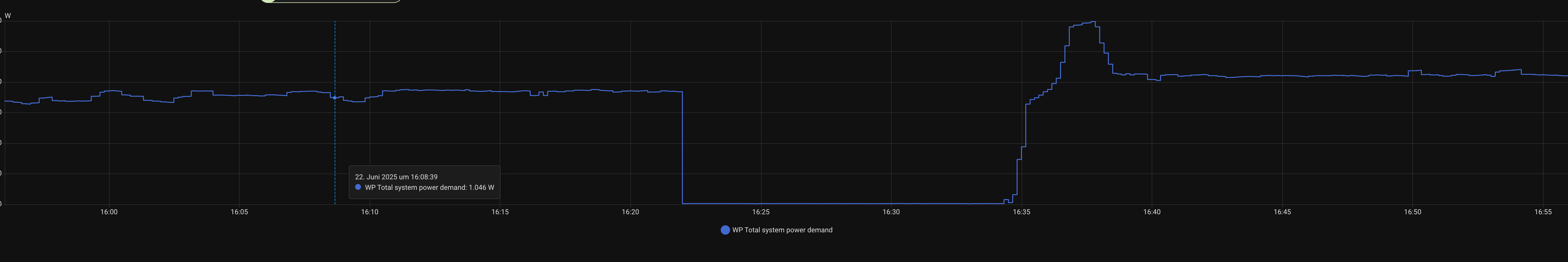

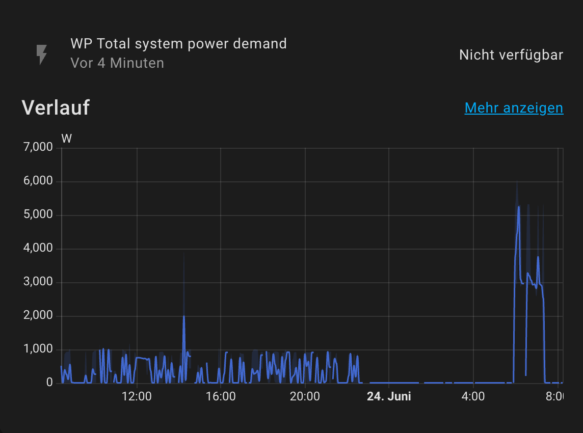

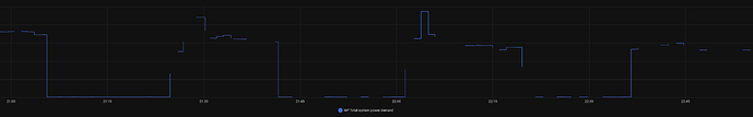

and here how it looks like after the update, note the interruptions
during that interrutptions the values are “not available”
here is the configuration, any idea how to fix?
