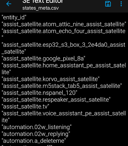

You are probably the third, the original question is how to export data to a file. Of course, it can be done in several ways, but for me, the hass object is better

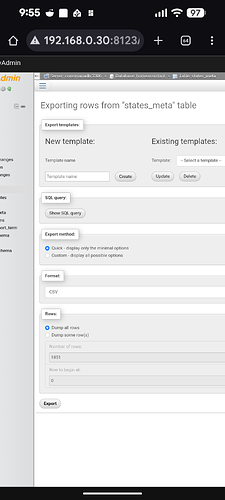

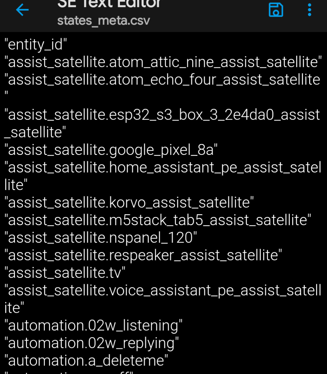

If you’re running HAOS you can install the phpMyAdmin add on and run the below query, at least with MariaDB, I’m sure it works with MySQL but I’ve been using HA for so long that MariaDB used to be the better option. You can then export the query as a csv file. You can see the state attributes table although like. Most databases things are tied together through unique ID’s generated but the names exist somewhere for automations, pretty much anything you create through the UI domain wise should be in the DB, learn some inner joins and and multiple tables to come up with some ‘fun’ queries. Just don’t manually update anything for any reason. Fine to look but don’t update unless you know about unique constraints and some minimal database exposure. 1 is my home assistant DB and yes, I got carried away with voice assistants and need to do some cleanup as I also have orphaned entities.
SELECT `entity_id' FROM 'states_meta' WHERE 1

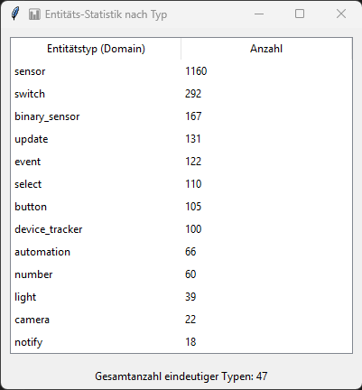

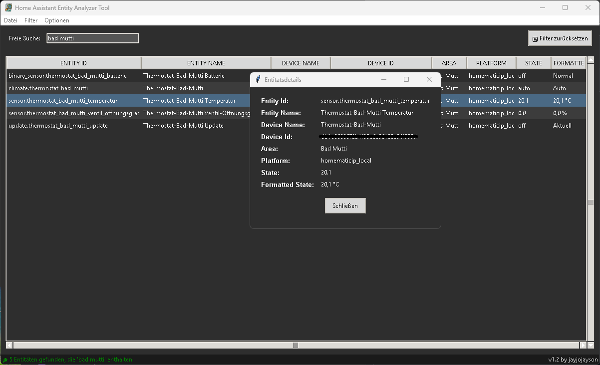

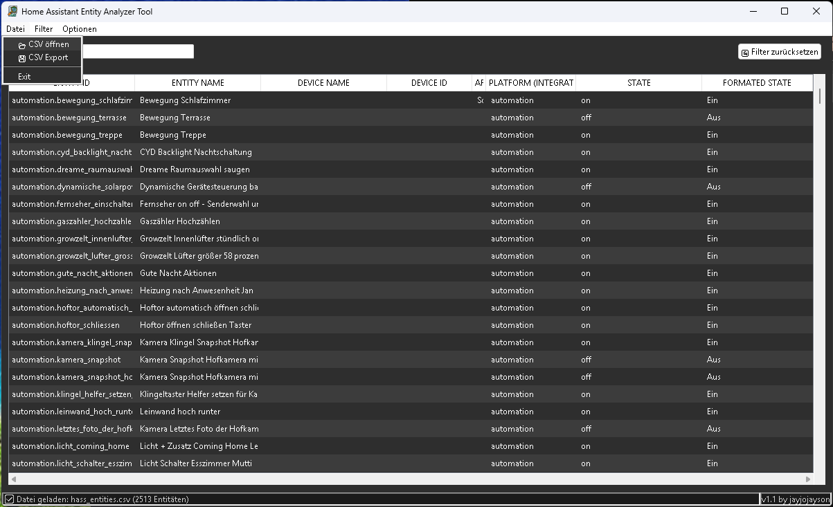

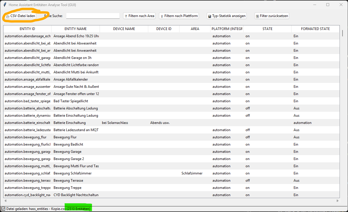

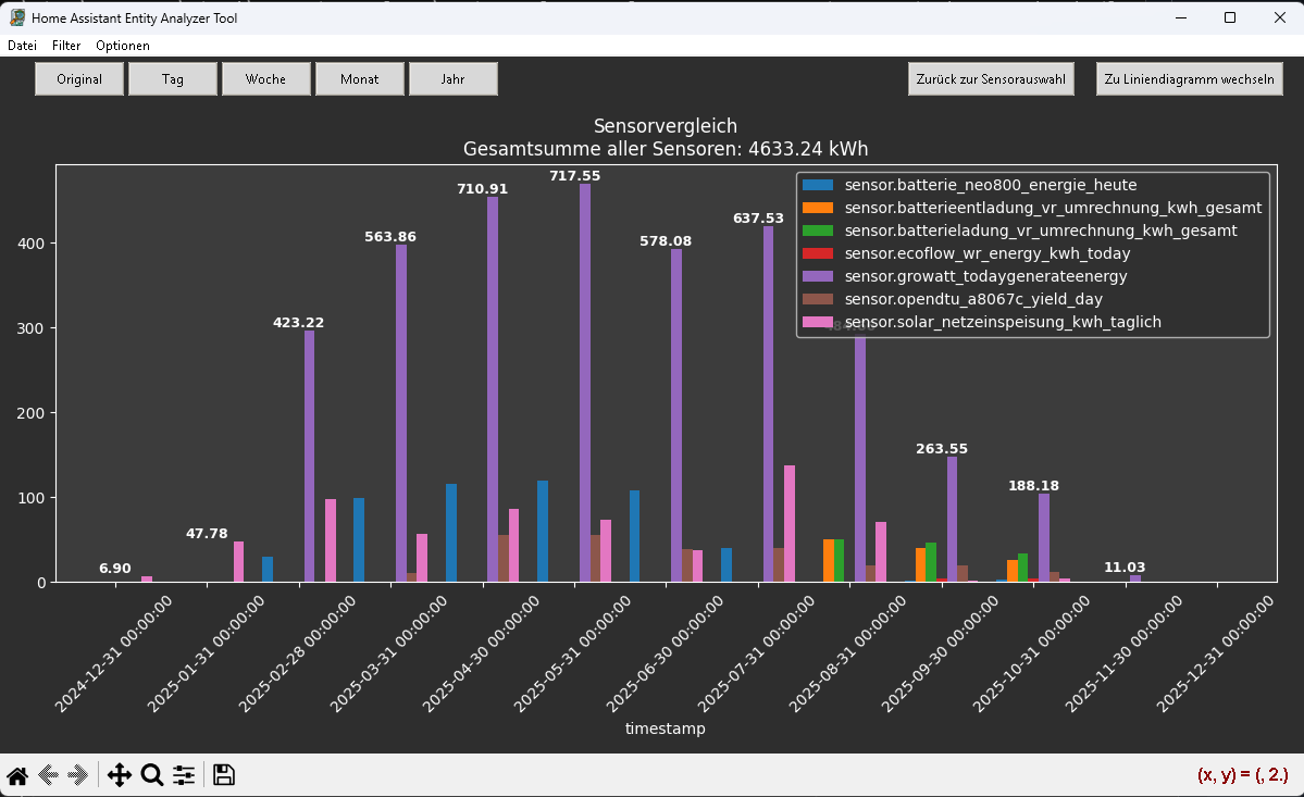

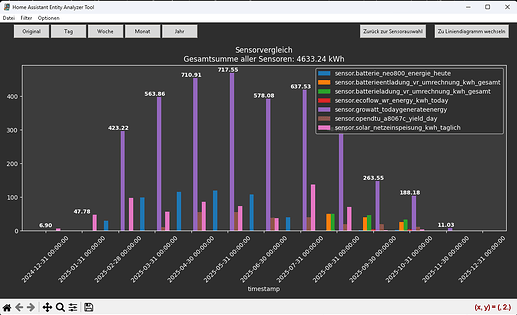

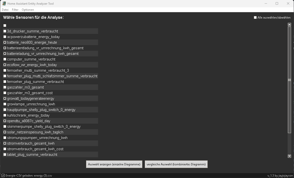

Hi Guys, i really like this option with the button-card to get a csv-file. Thanks for that! I have done a little Analyzer Tool with python for the csv file. To get it working, the formatting of csv is changed from comma to semicolon. If you like it you can check my github. There are two Version, a executable exe for Windows and a py to get it work with Linux.
some pics:

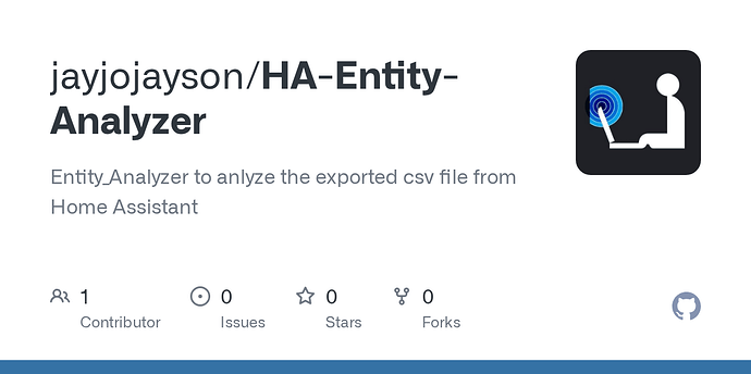

If you are interested, there is a new Version of the HA_Entity_Analyzer_Tool:
https://github.com/jayjojayson/HA-Entity-Analyzer
App-Features
  • :page_facing_up: simple Entities Tool to analyze your csv-file
  • ↔️ import and export csv file
  • :mag: free entity search
  • :bookmark: area & platform filter
  • :bar_chart: entities statistic
Gui-Features
  • works on win, (macos & linux in progress)
  • dark/lite mode
  • app on top (keep in foreground)

              clean(stateObj.state),
              clean(hass.formatEntityState(stateObj)),
              clean(manufacturer),
              clean(model),
              clean(model_id),
              clean(sw_version),
              clean(hw_version)
            ].join("; ");
            csv += row + "\n";
        const blob = new Blob([csv], { type: "text/csv;charset=utf-8;" });
        const url = URL.createObjectURL(blob);
        const a = document.createElement("a");
        a.href = url;
        a.download = "hass_entities.csv";
        a.click();
        URL.revokeObjectURL(url);
      generateCSV();
I`m wokring on a new version of my HA_ Analyzer-Tool. Now HA can export csv energy reports, so i tried to integrate that in my tool. Will be released next days.
Hi, version 1.3 is online; anyone who wants to can download the tool. It’s now possible to view your exported energy.csv file from HA. You can select, compare, or view individual energy sensors.
A new filter, Manufacturer, has been added for viewing the standard export list of entities from HA. So there are a few new features. The tool can now finally be installed for Windows, Mac or Linux; the corresponding files are available in the Download.
