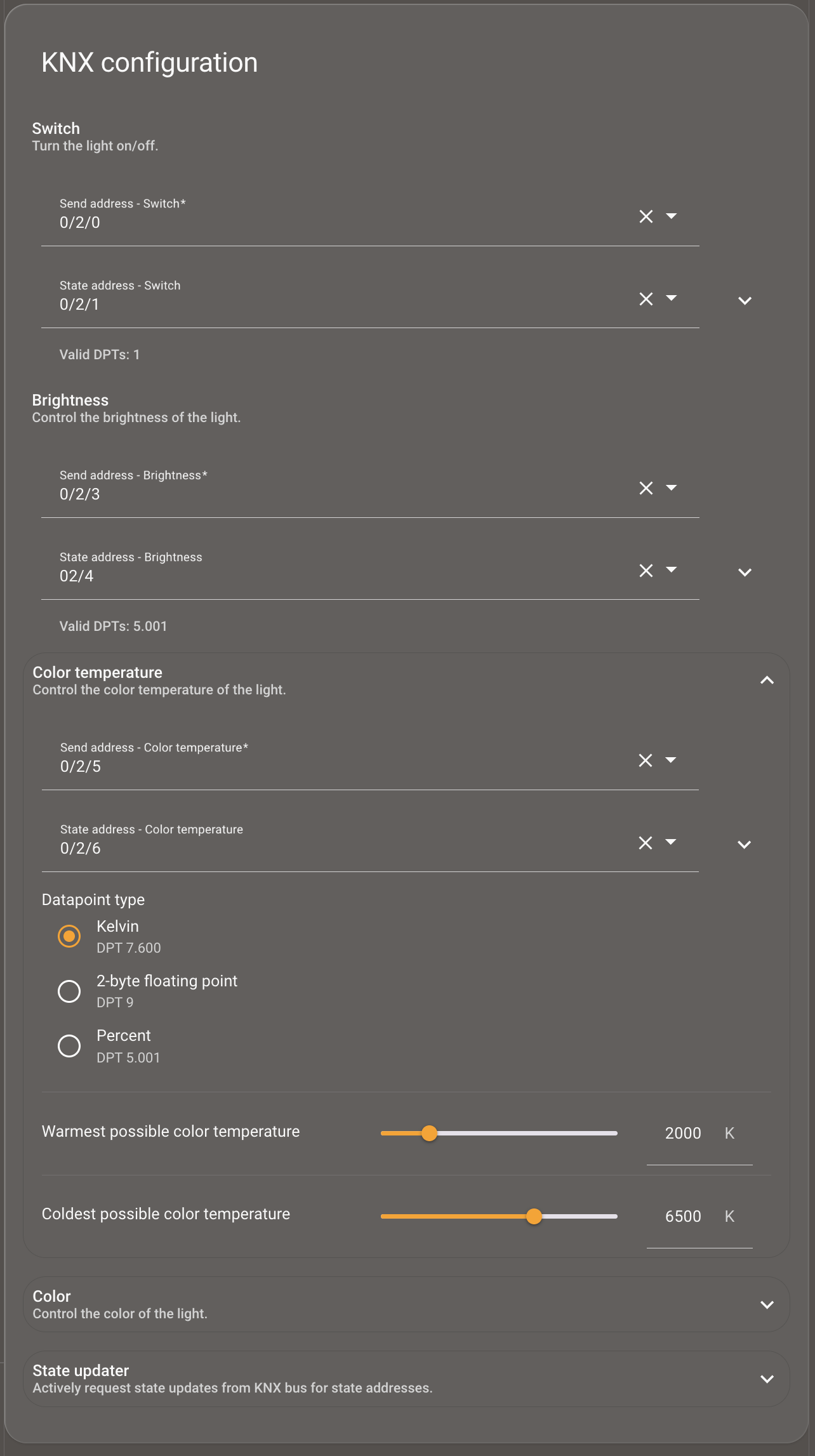

Hi, I would like to expose an Home Assistant light (Hue light) to my KNX system in a bi-directional way.
What I have done so far is:
  1. Defined group addresses for the Hue light in ETS
  2. Added a KNX Light entity in the HA KNX integration pointing to those GA
  3. Added a blueprint and related automation to sync the KNX light with the Hue light bi-directionally
If I control the Hue light, the KNX one is synced, and vice-versa. But if I send a on/off message from ETS to either the OnOff GA or the OnOff State GA, nothing happens.
What should I do to make HA react to the values I write from ETS to the GA?

Hi :wave:!
My recommendation would be to skip this
as such proxy-entities that can’t get a state from the knx bus have their pitfalls. Just use knx.telegram trigger and knx.send actions instead. Alternatively you could have a look into knx expose.
Or have a look at this blueprint: Advanced control of any light entity from KNX (state, brightness, dim, temperature, color + states feedback)
Thanks, I tried that blueprint, if I control the light from HA it sends the values to KNX, but not the other way around. I don’t even see the on/off command on the BUS monitor though, am I missing something? I do see the messages from the ETS group monitor, just not from the HA one
If knx.send can properly send to the bus, I don’t know.
Maybe ask in the blueprints thread - sharing your configuration.
I don’t think it has anything to do with the blueprint, if I send a GA telegram from ETS I would expect it to show up on the HA KNX Bus Monitor, no matter what :thinking:
So which direction works, and which doesn’t?
It could be a filter-table issue. Are you using routing or tunnelling connection?
I changed the OnOff GA to the one configured on a keypad and it works :thinking:
