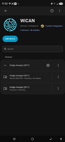

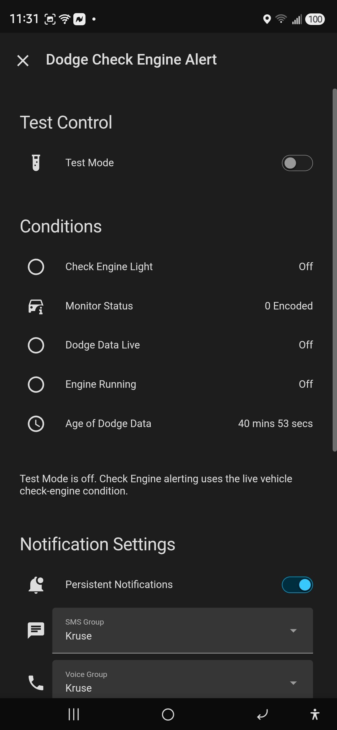

Note the following screen shots, I have an older Dodge and a Wican Pro plugged into the ODB diagnostic port. The Wican connects to my home WiFi when in the driveway to quickly capture data when we arrive or leave home.
The Wican is also transmitting its own WiFi SSID.
I always have my phone with me with the HA companion app and WiFi is always turned on.
So you see where I am going with this... How can I get data Wican -> HA Companion App (which would then get the data into my HA server) while the car is running and not at home?

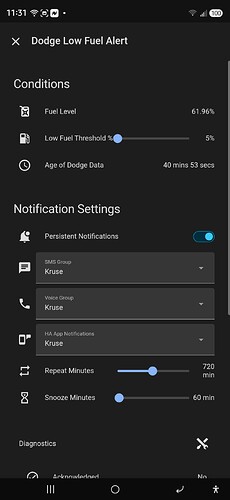

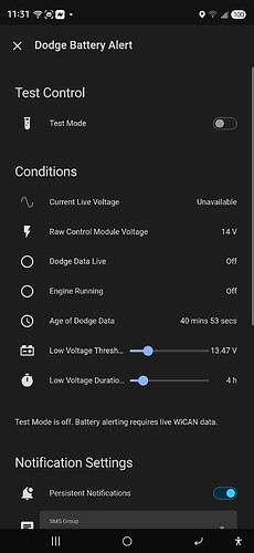

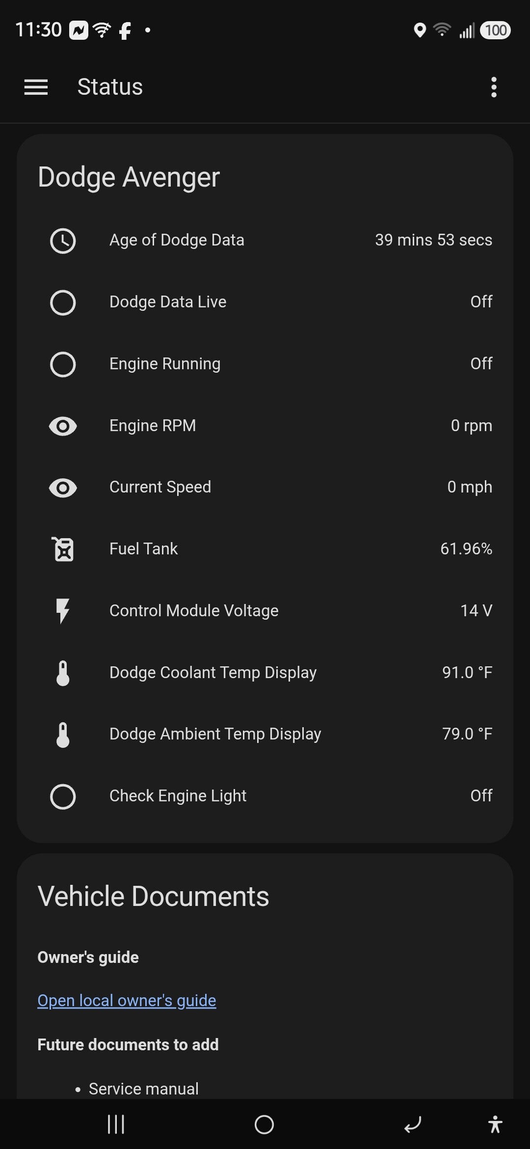

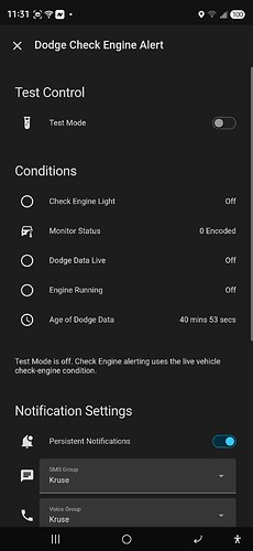

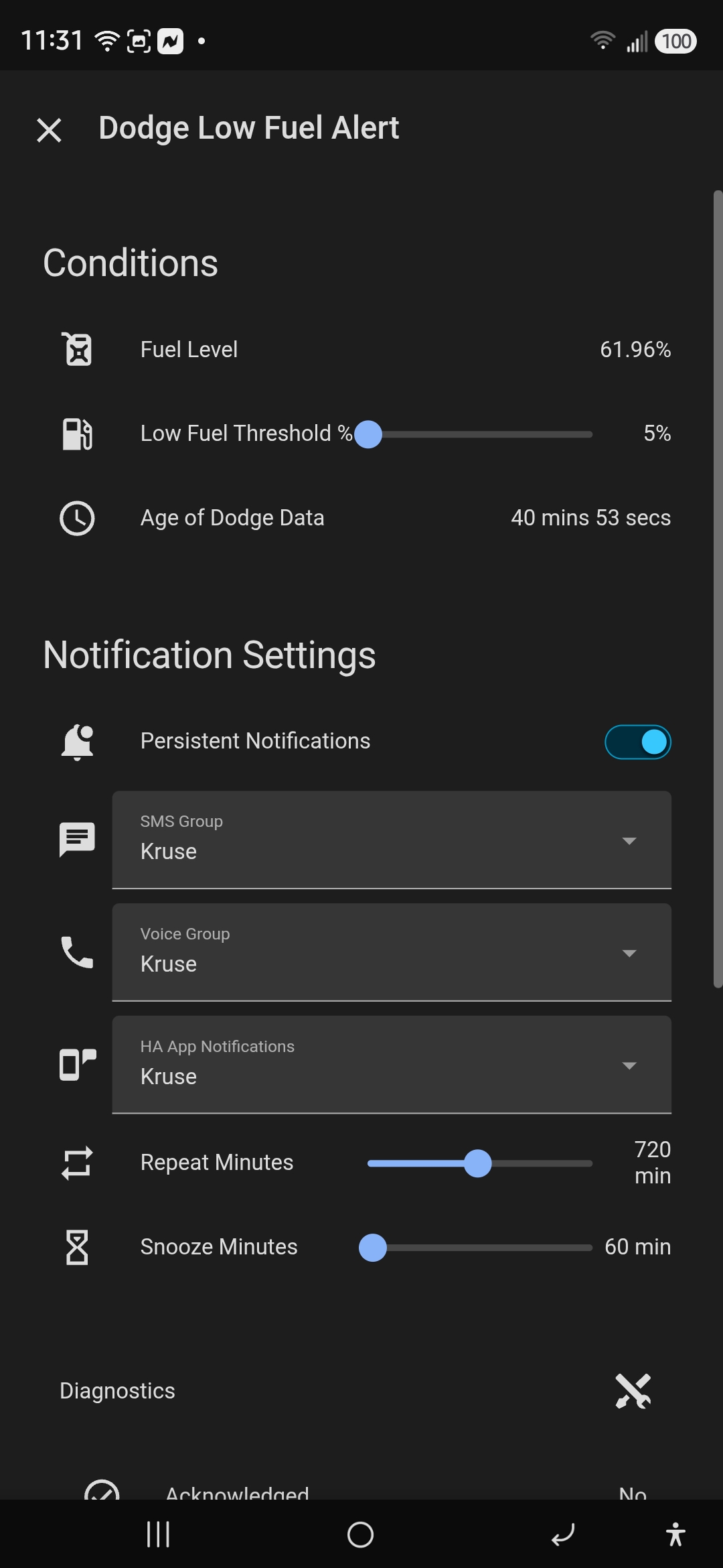

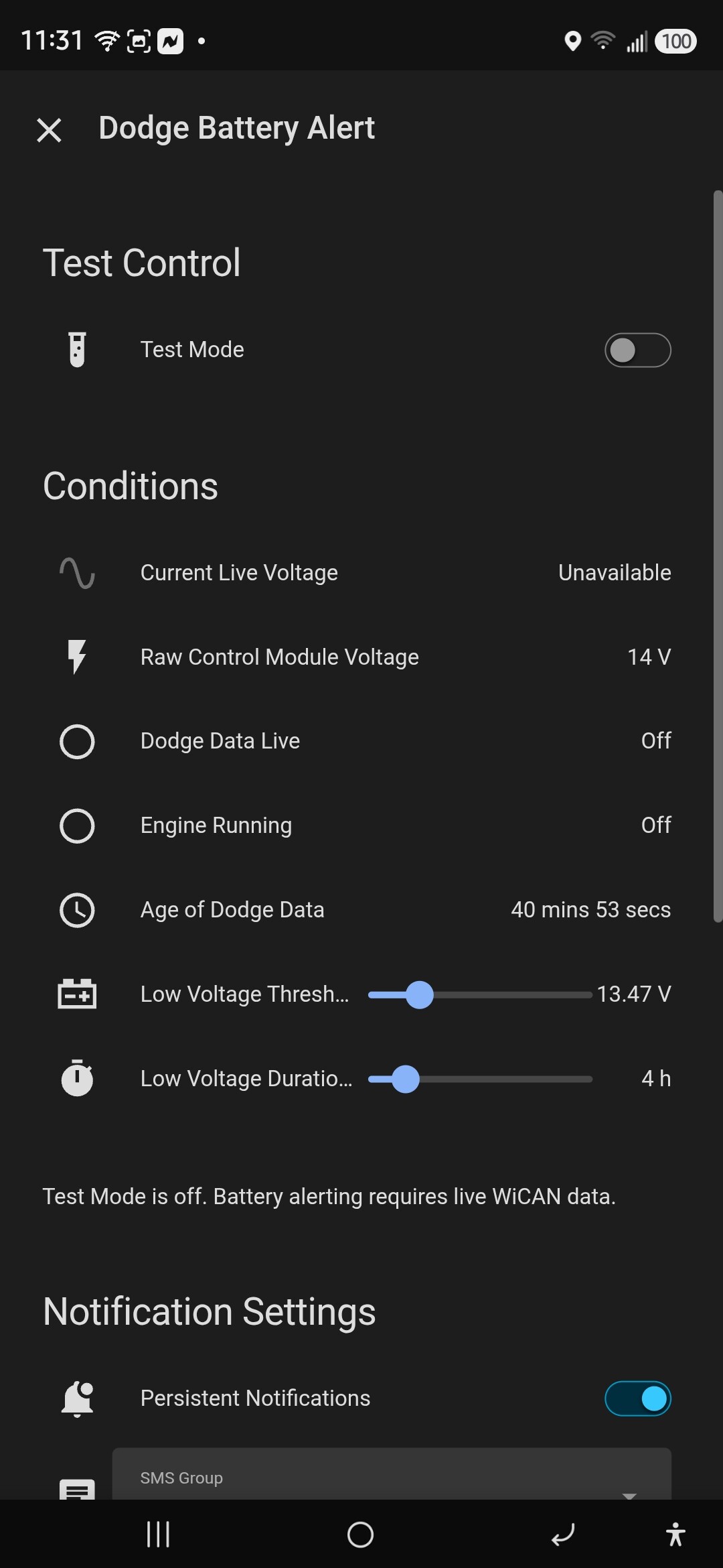

Below are some screen shots of a dashboard I built out in HA to monitor the car as well as a framework for alerts I've built that can be sent by SMS Text, Voice Phone Call (via Twilio), as well as HA Notifications and/or Persistent HA notifications. The alert pattern allows me to easily send any type of message to any set of predefined people.
Long story short, especially using AI these days, it is pretty easy to build out very sophisticated stuff in HA, so I'd like to take this to the next level and get data into HA while away from home via whatever APIs necessary without buying more hardware.
