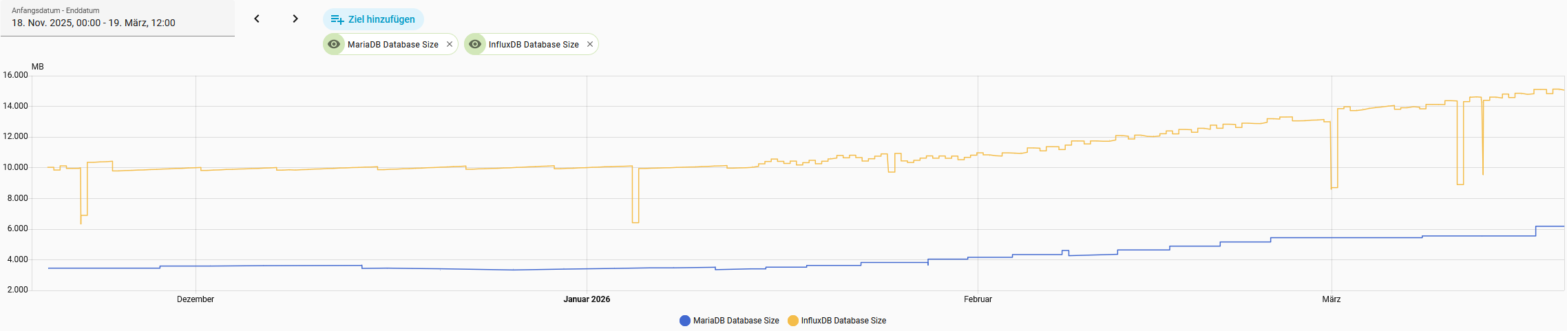

I have a problem with my HA database growing pretty significant since some month. After trying to figure out what might be the reason I’m even more confused than before and think my configuration might be messed up. Because I hope that my history data is still there, I wanted to ask for help before deleting anything.
The database started to grow mid january, as you can see in this graph. You can also see that there is no data before 19. November, so there is only 4 month of data.

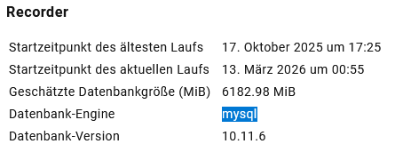

In Settings > System > Repair and then on the …-menu it lists mysql as database-engine for the recorder. So I’m not sure if any HA update might have messed um the MariaDB config and I’m now having 3 databases in parallel?!

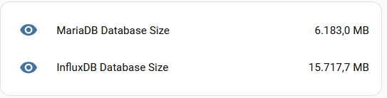

I don’t know where you got that number, but my databases are much bigger. 6 GB of MariaDB (Recorder) and 10 GB of InfluxDB (History). Interestingly InfluxDB has been 15 GB this morning but somehow got down to “only” 10 GB, which is the same size as in November 2025 before the increase in size started. Still, MariaDB was only half of the current size back then.
EDIT: Nevermind, the InfluxDB just went back up to 16 GB

Oh I think you missinterpreted that Y-scale wrong. I’m from germany, so the . (point) is NOT the decimal separator. We use the , (comma) as decimal separator. So 20.000 MB is 20 GB.
