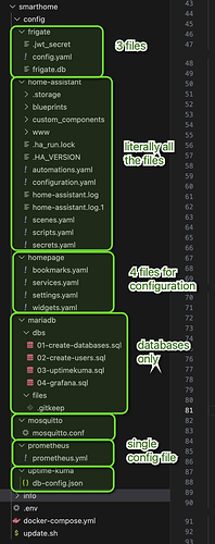

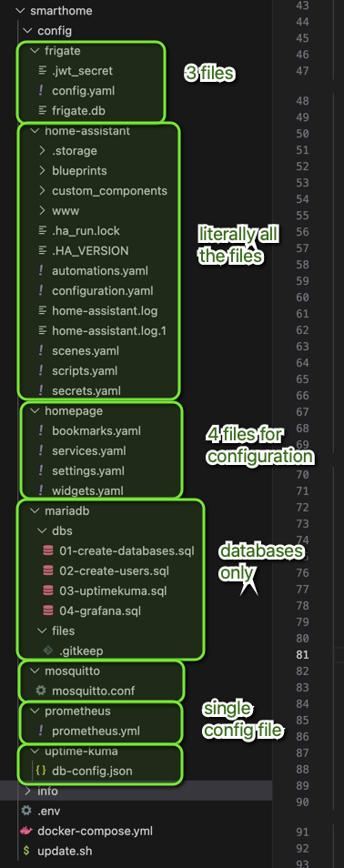

That’s it though. events and parameters for history. Whereas it could store device information, automations, scripts, scenes, tokens, and basically all the information. My point is, if an external database was used, .storage would not be needed.
You mentioned grafana, which I use to create dashboards, and this is it’s configuration. I don’t even have to mount a volume. Everything goes into mariadb. I can delete the container and re-create it, and I wouldn’t lose a single byte.

it kind of creates a mess on my repo. defeats the point of using containers.
and these are the containers that need a volume, all the others simply write to databases.
