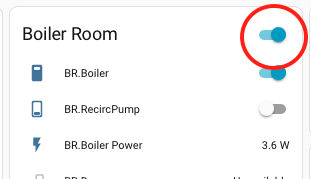

Hi! What are these extra switches? When I have more than one switch in an area they show up. They come on if I switch either switch on, and if I turn them on they turn on both of the “regular” switches. Can they be made to disappear? I’m running the latest of everything with HAOS running on an RPi. Thanks!
It’s called a header toggle that controls all of the entities:
Just disable it in the editor for the card.
