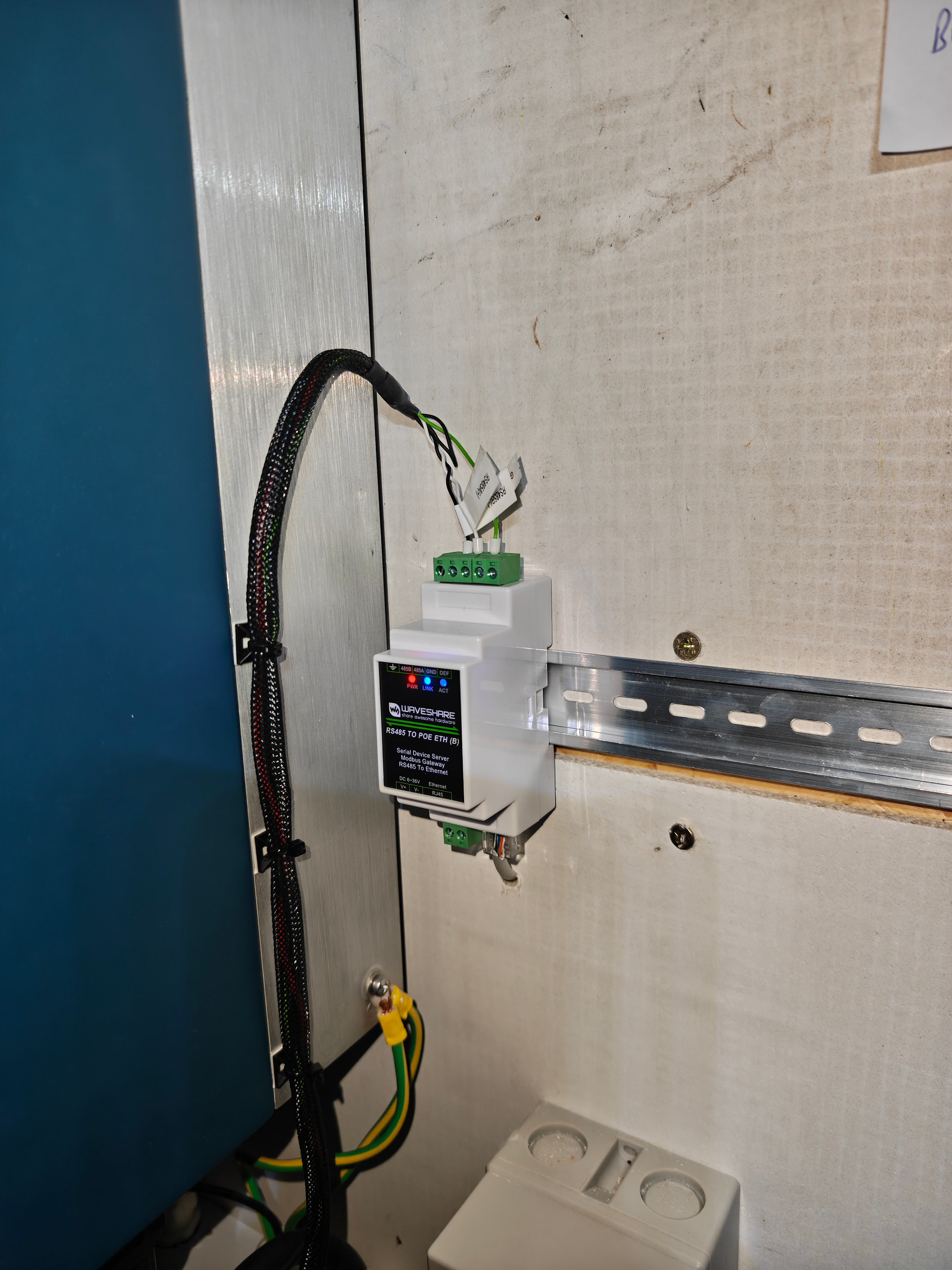

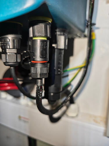

What I had not realised until I went looking is that the cloud was only ever a middleman. My inverter appears to be a rebadged Solis, and underneath the branding there is a standard Modbus interface. The COM port is a proprietary 4 pin connector and there is only one of them, so the Autarco WiFi stick had to come out to free it. I bought the plug on eBay.de and soldered my own cable onto it. RS485 A and B on pins 3 and 4, ground on pin 2. https://ebay.io/m/2rMHiV
From there it is RS485 straight into Home Assistant using the SolaX Modbus integration, which supports Solis hybrids. Fully local. No cloud, no API key, no account, nothing leaving the house. GitHub - wills106/homeassistant-solax-modbus: SolaX Power Modbus custom_component for Home Assistant (Supports some AlphaESS, Growatt, Sofar, Solinteg, Solis, SRNE, Swatten) · GitHub
Adapter: https://amzn.eu/d/0aiCO6Da
