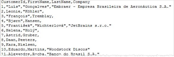

If you just want to dump the data to .csv, this is what you’re looking for:

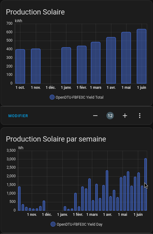

Why i only have 10 days from my database ?

I believe the default Recorder purge_keep_days is 10. After that, old events and states data are purged and, for some types of data, summarized in the statistics tables.

Ok, but explain to me why i have data more than 10 days on graph and how to get it ? Thanks a lot
As for how to get it, presumably you could query the statistics tables. I haven’t done so, so I can’t be much help there.
Live data is states.
History > live stats and the live stats are distilled down in the history as they fall out
The UI blends both
