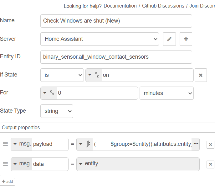

The following is in my check windows sensor node as the payload
   $group:=$entity().attributes.entity_id;
   $names:=$entities().*[entity_id in $group and state="on"].attributes.friendly_name;
   $yes:="Warning! Windows open! The windows are: " & $join($names, ", ") & ". Warning!";
   $no:="No windows are currently open";
   $count($names)>0 ? $yes : $no

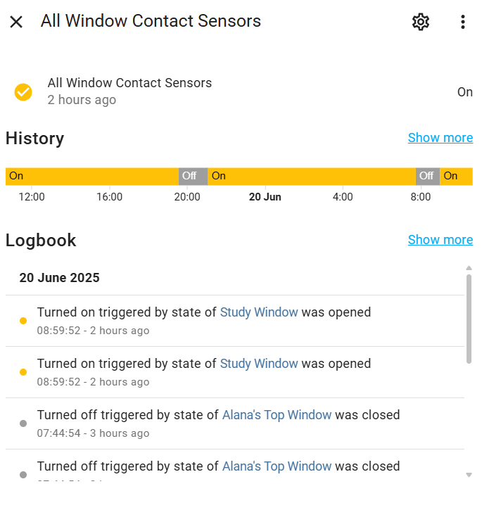

The group in question shows the correct state:

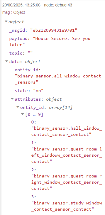

And it passes a payload. Unfortunately it only ever passes the No payload…
So it appears the $names variable is no longer populating
Does anyone know why this might be, and more to the point, how to fix it?!
Edit: checking the complete message object it doesn’t look like it’s obtaining any state for the entities within that. Maybe that’s okay?
