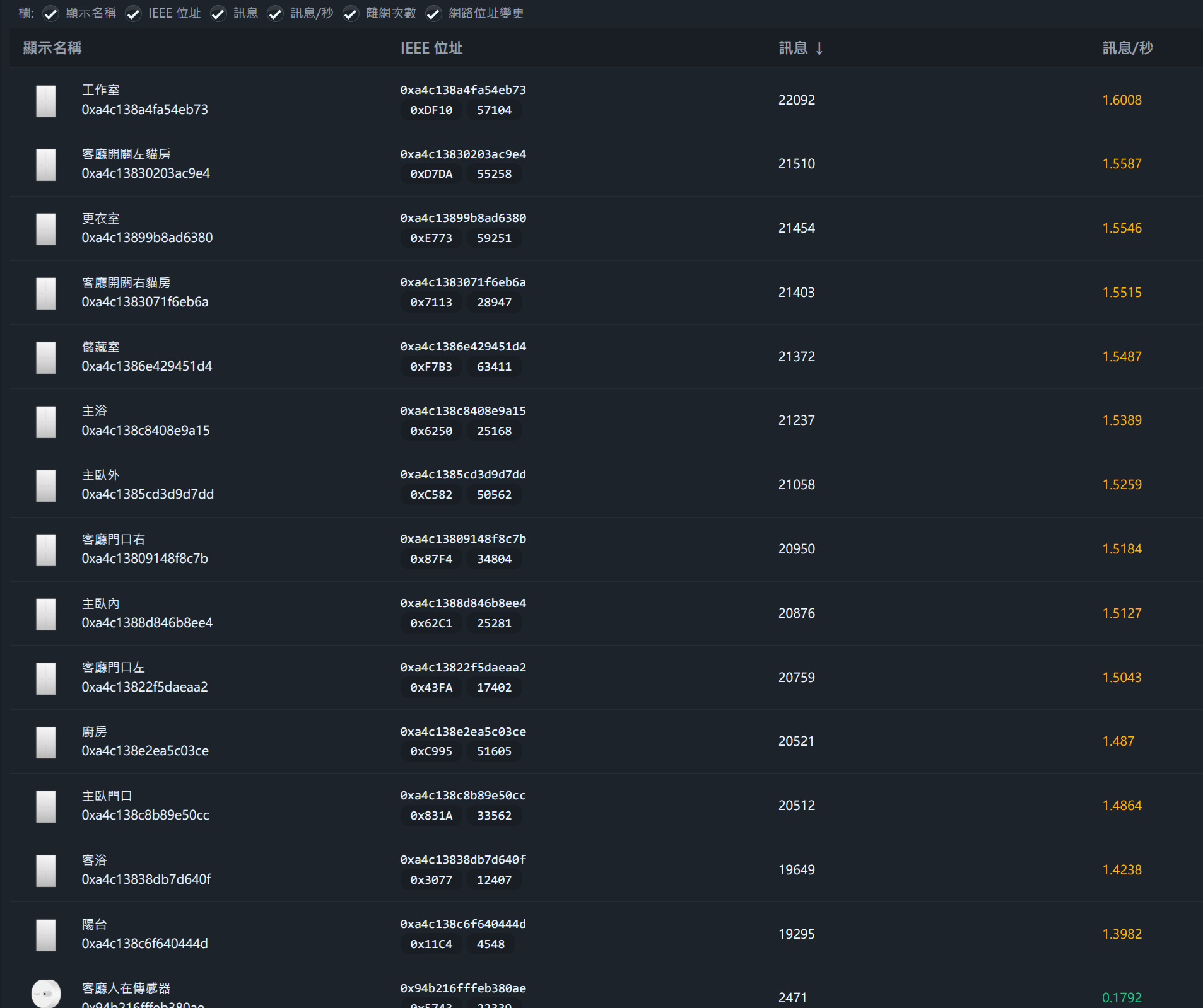

​After digging into the Z2M Health dashboard, I discovered massive background traffic. These switches are constantly spamming the network, with some showing as high as 1.35+ messages per second, flooding the gateway non-stop.

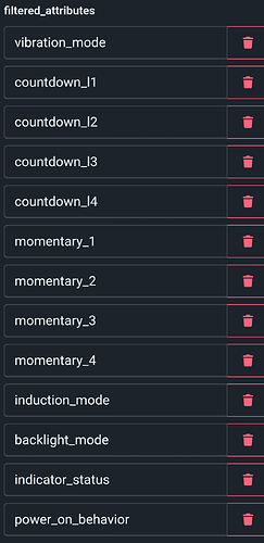

​Individually added all unused or redundant entities (e.g., vibration_mode, countdown_l1-l4, backlight_mode, indicator_status) to the Filtered attributes list.
​Switched some of them to Scene Mode to stop local state loops.
​Despite filtering out these bulk payloads, the message frequency from these Tuya chips remains incredibly high, and the airtime congestion persists.

Which version of Z2M are you running? Asking because what you're seeing seems identical to this issue, but that was fixed last November.
