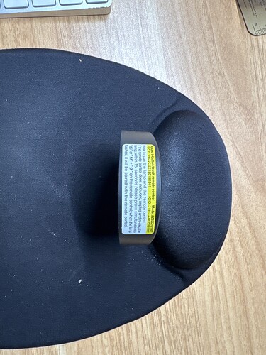

Would anyone know of a way to control this lamp with HA?
The round item is the remote:
This is the FCC ID: 2BD2C-ZZ02DY01007
I just need a nudge in the right direction
Thx!!

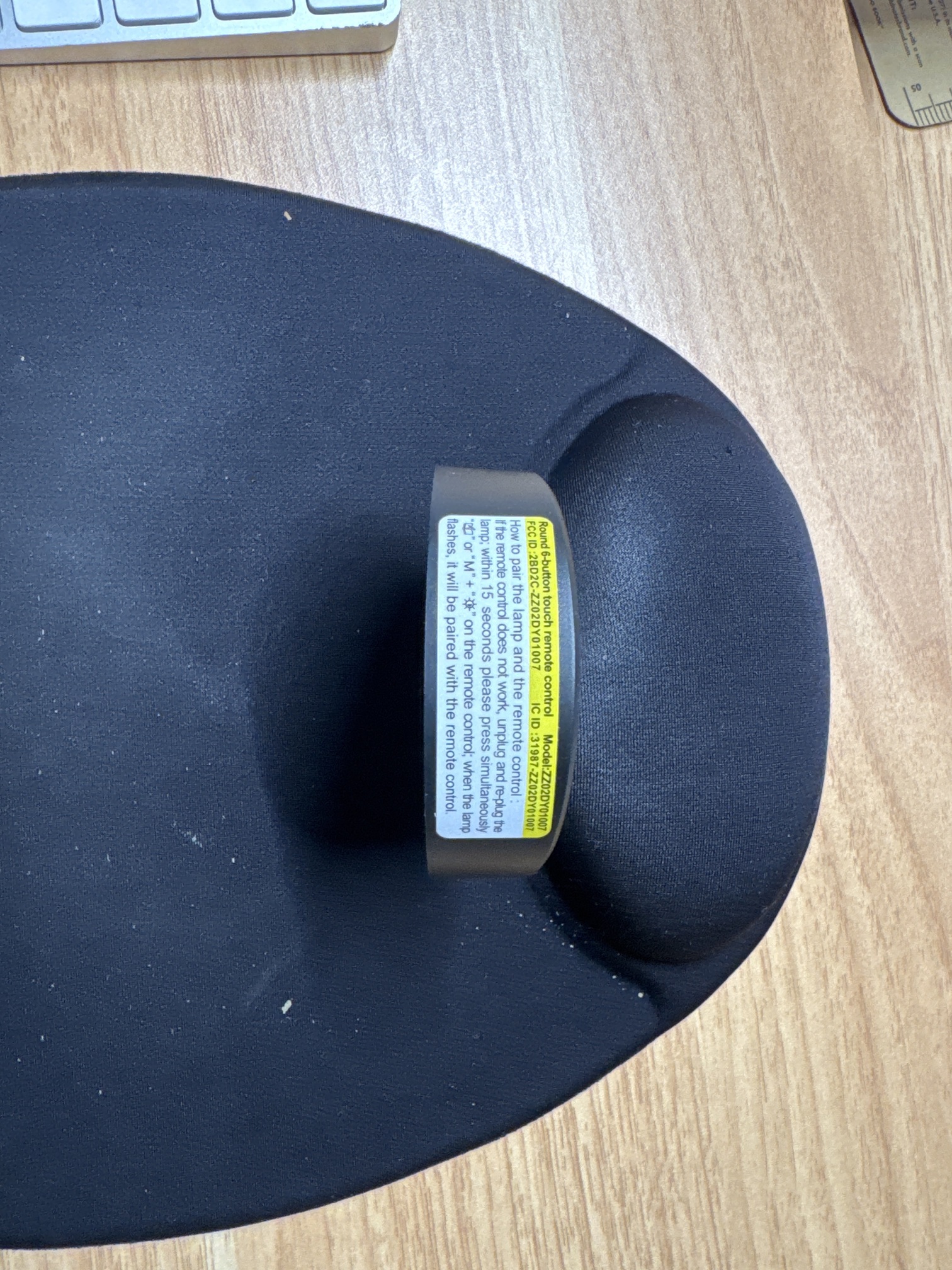

Hi all, Happy New Year!
Thx!!
Wouldn’t get my hopes up. According to the Amazon listing, it looks like the remote is bluetooth, so you need a bluetooth integration that’s specific for this lamp.
Best you can do is stick an ESP32 device inside the remote and get it to press the right buttons

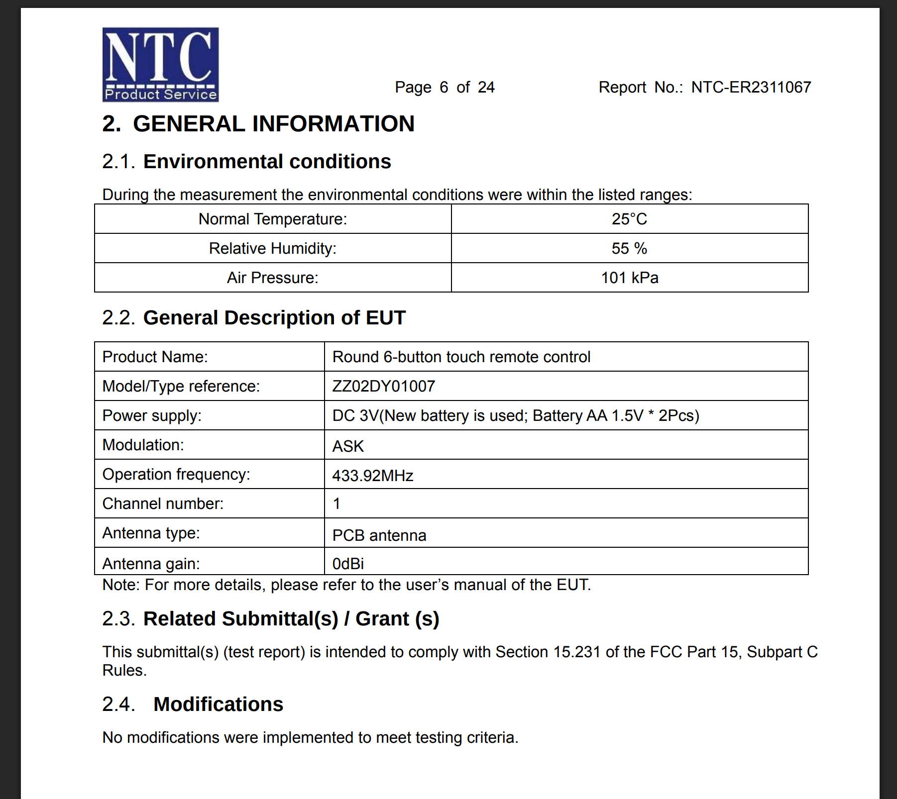

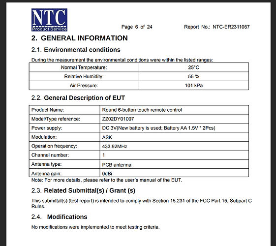

I have the same lamp and am seeking the same solution. I believe its RF looking at the label.
I made it work with esp32 and flipper: GitHub - bl4ko/eyocean-ha: ESPHome-based Home Assistant integration for EYOCEAN LED desk lamps via 433MHz RF (EV1527 protocol) · GitHub
