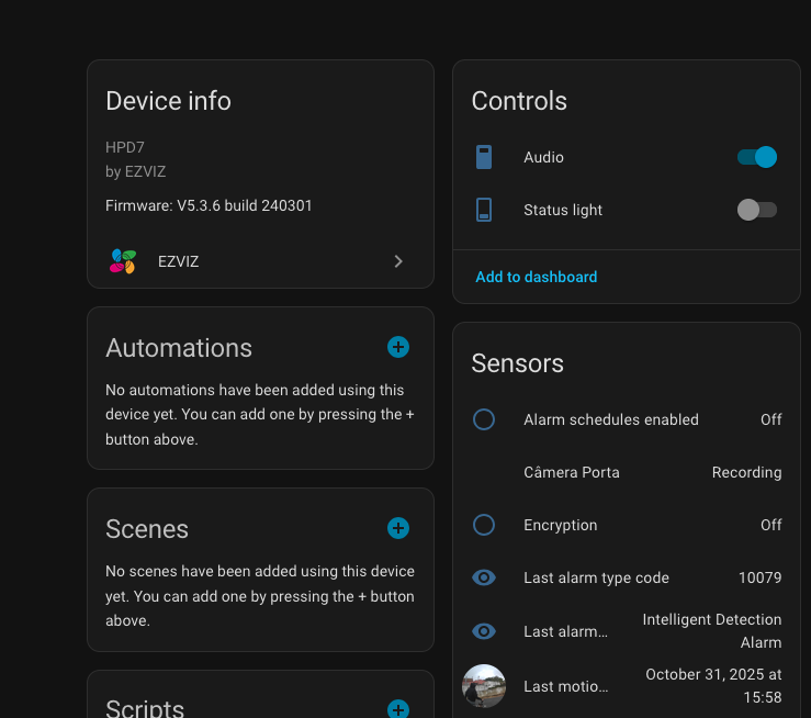

You cannot see a live feed or pickup “a call” when someone rings, but you can see the last motion trigger image. Turn on or off the bell, turn on or of the light.
