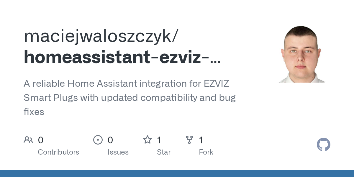

You can use this one, works fine and it’s maintained.
