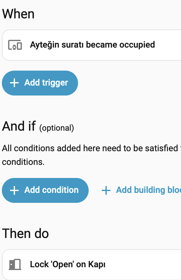

I want to create an automation. The simple one works fine, when camera detects my face, in unlocks the door.
But to prevent accidental unlocks, I want to make it such that,
When camera dedects my face and after dedection if I ring the doorbell in 5 seconds, then it should open the door. Not everytime it dedects my face :slight_smile:
How can I achieve this? The current simple automation can be seen below:
Start with your normal trigger.
Skip the condition part, and in the actions, use a wait for a template which should do what you need.
Thanks Rofo, will give it a try today.
Rofo, with your support, it is working now as I needed, thank you again!
