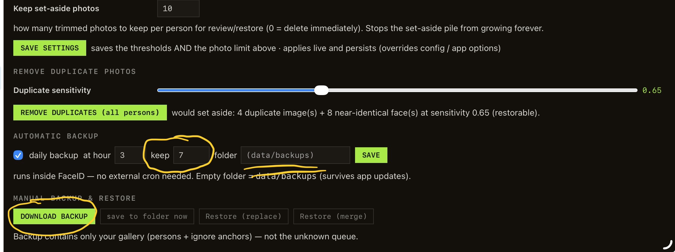

While testing the Backup & Restore functionality via the Home Assistant Companion app on my iPad, I noticed a couple of inconsistencies:
  • The Download Backup button appears to always download only the most recently created backup. Is that intentional? I was expecting some way to choose an older backup if multiple backups are available.

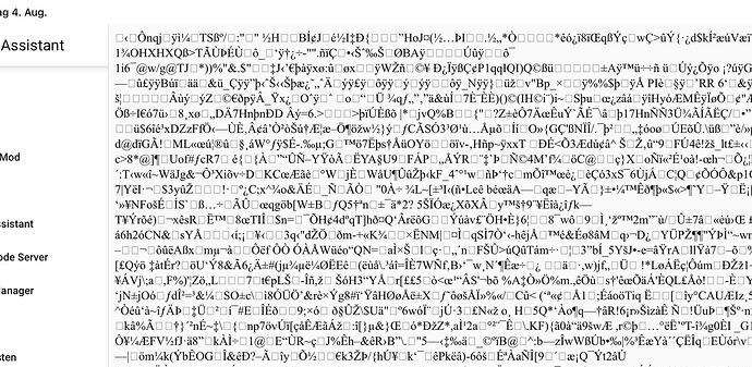

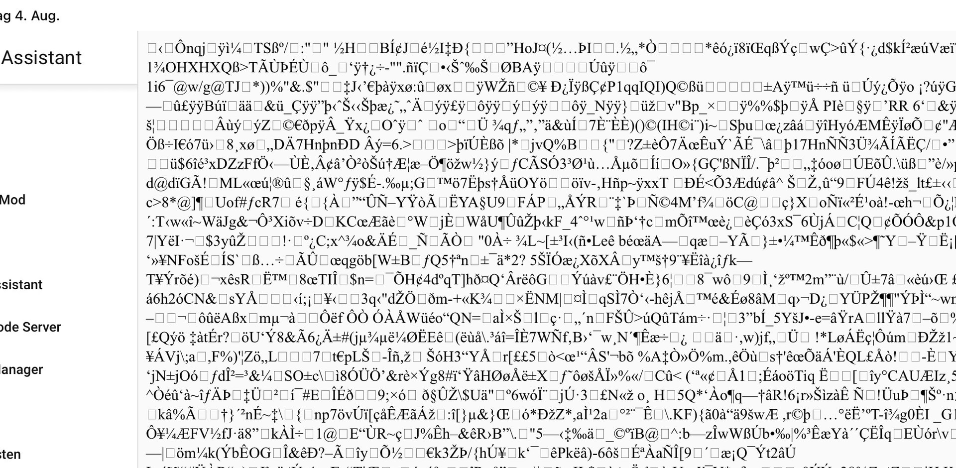

  • Also, tapping Download Backup doesn’t actually download a backup file on iPad. Instead, it opens the backup directly in the browser/viewer as plain binary data (see screenshot below), resulting in a page full of unreadable characters instead of prompting me to save the backup as a file.
I’m not sure whether this is a limitation of Home Assistant’s file handling or something FaceID could work around, but I thought I’d mention it since it makes restoring or archiving backups a bit difficult when using FaceID through Home Assistant.

@lemuba Good catches, both of them — and one was worse than you described.
Saved backups are now listed and individually downloadable (Settings, under the
automatic backup section): date, size, and a download link per file.
Your observation was right, my mechanism was slightly different from what you assumed:
the button never downloaded “the latest backup” — it built a fresh archive on every
click. The files written by backup now and by the daily job were not reachable from the
UI at all. On a normal install you could still fetch them over SSH; running as an app,
they were effectively invisible. That was an oversight, not a design decision.
The iPad problem should be fixed, but I cannot verify it myself. The
Content-Disposition: attachment header was already being sent — Safari simply ignores
it for application/gzip and renders the archive inline, which is the character soup you
saw. The download now uses application/octet-stream plus a download attribute on the
link, which normally persuades iOS to save the file.
I have no iPad here, so please tell me whether it actually behaves now. If it still opens
inline, the next thing to try is a long-press on the link and “Download Linked File” —
that would tell us whether it is the header or Home Assistant’s ingress rewriting the
response.
