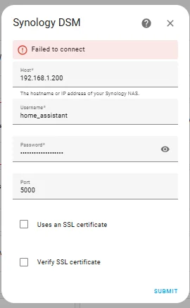

After the migration to new Synology hardware, I have been unable to connect Home Assistant to my Synology NAS using the Synology DSM Integration. The integration simply asks for IP address, admin user name, password and port (5000)…

The following is in the logs.

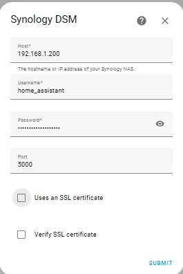

I’m wondering why “ssl=True” is in the logs although the “Uses an SSL Certificate” is unchecked in the Synology Integration login dialog (see screenshot) and causes the “is_ssl=False” in the logs. (Note that this checkbox is checked by default in the Synology Integration login dialog.)
Logger: homeassistant.components.synology_dsm.config_flow
Source: components/synology_dsm/config_flow.py:215
integration: Synology DSM (documentation, issues)
{'api': None, 'code': -1, 'reason': 'Unknown', 'details': "ClientConnectorError = ConnectionKey(host='xxx.xxx.x.xxx', port=5000, is_ssl=False, ssl=True, proxy=None, proxy_auth=None, proxy_headers_hash=None)"}
