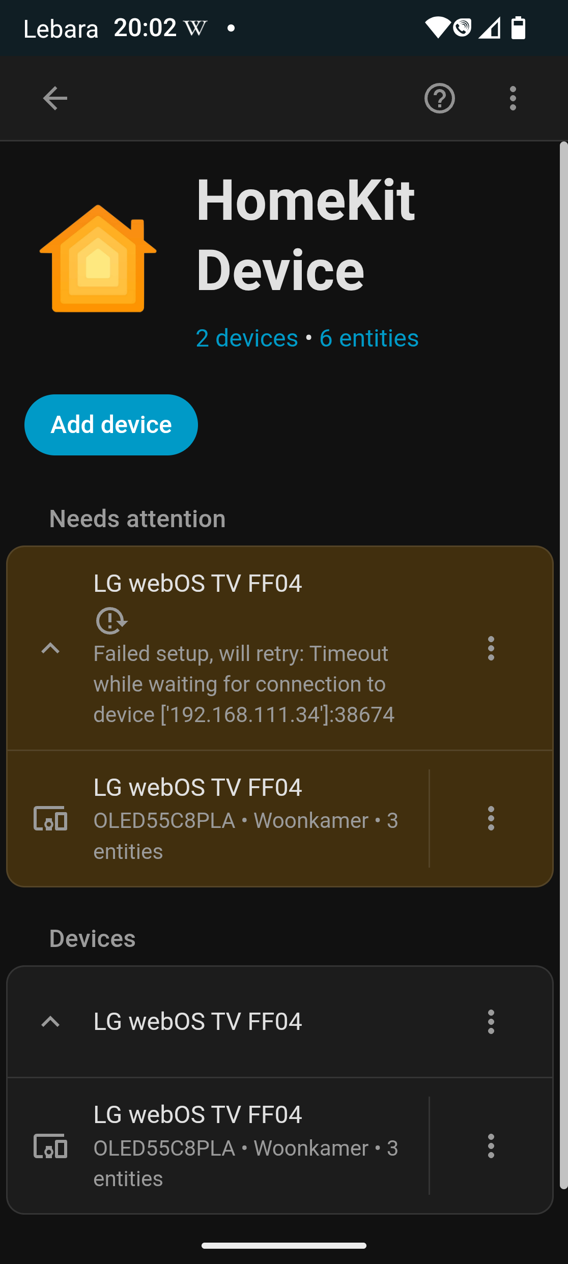

Failed setup WebOS LG TV
Is WebOS third party integration? Anyway it appears multiple times. And yes I did open another question but one screen shot is not much to go on
So in the setup, did you use only the IP address only? No port address in mine as I know of. If the unit is setup using DHCP the IP may change, do you need to check it in your router and set it accordingly.
It was there now it is gone again:
It was disconnected for a short time. How do I restart the discovery process?
I see it in devices not problem but under entities it is unavailable.
