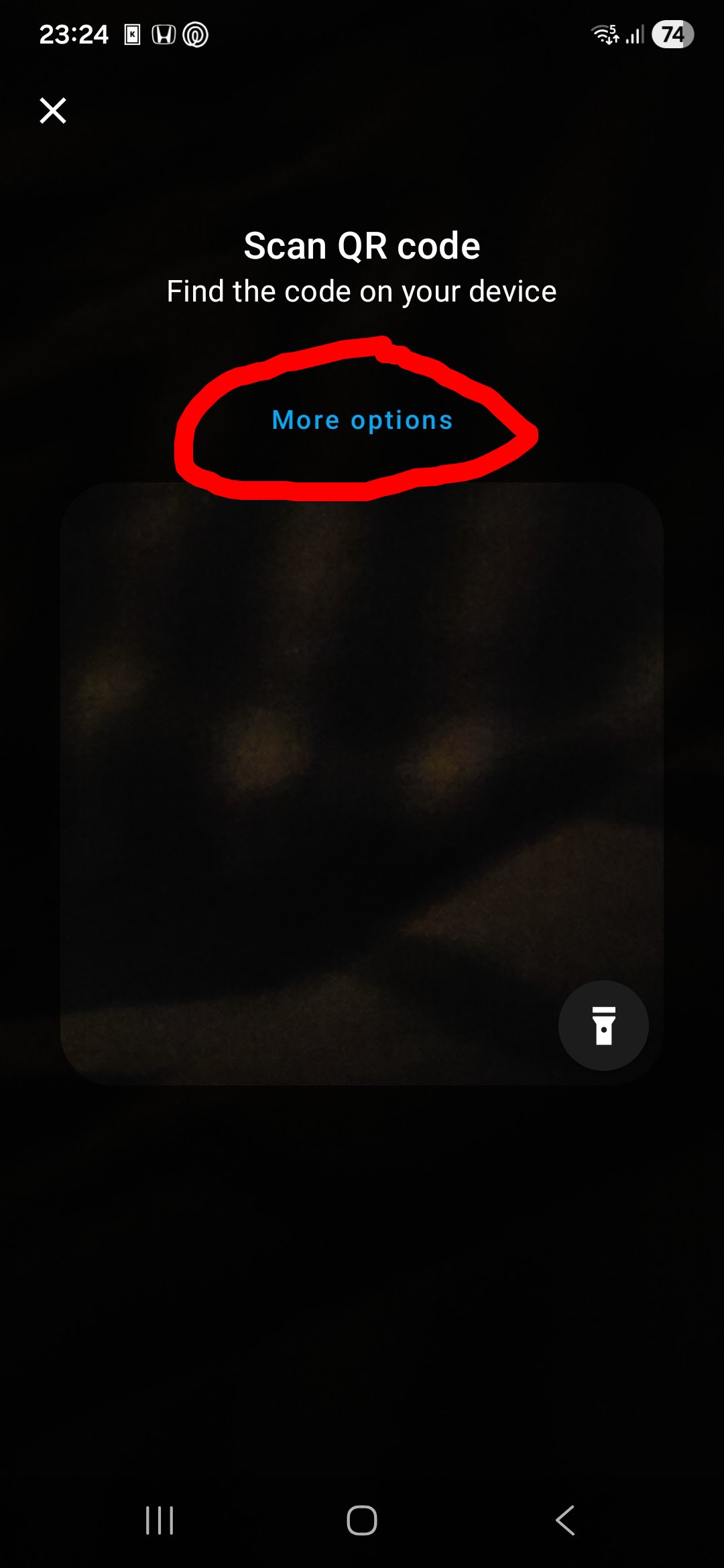

nop thats wrong, if you scan the barcode you should only plug it in, do not pusch any buttons, (scan, then ad the device, then plugg it in, then it will take some time and it will be added) i never use that (smart start) i prefer to put homeassistant in inclusion mode (not scan) click on “more options” in homeassistant and pick “Search for device” then you click once on the device and it should blink pink, after 30-60 sek it vill include, you need to ad the s2 code manuely (its stated on the device)

3: Now click on add a z-wave device on the phone, see picture 4-5
when you have started the search, click once on the z-wave device so that it flashes pink,
now you will soon get a question about the S2 key, this is on the device in very small text, take a photo or write it down before you start. Now you should have the device in. Remember to take it easy, it can take 1 minute before HA finds the device.
