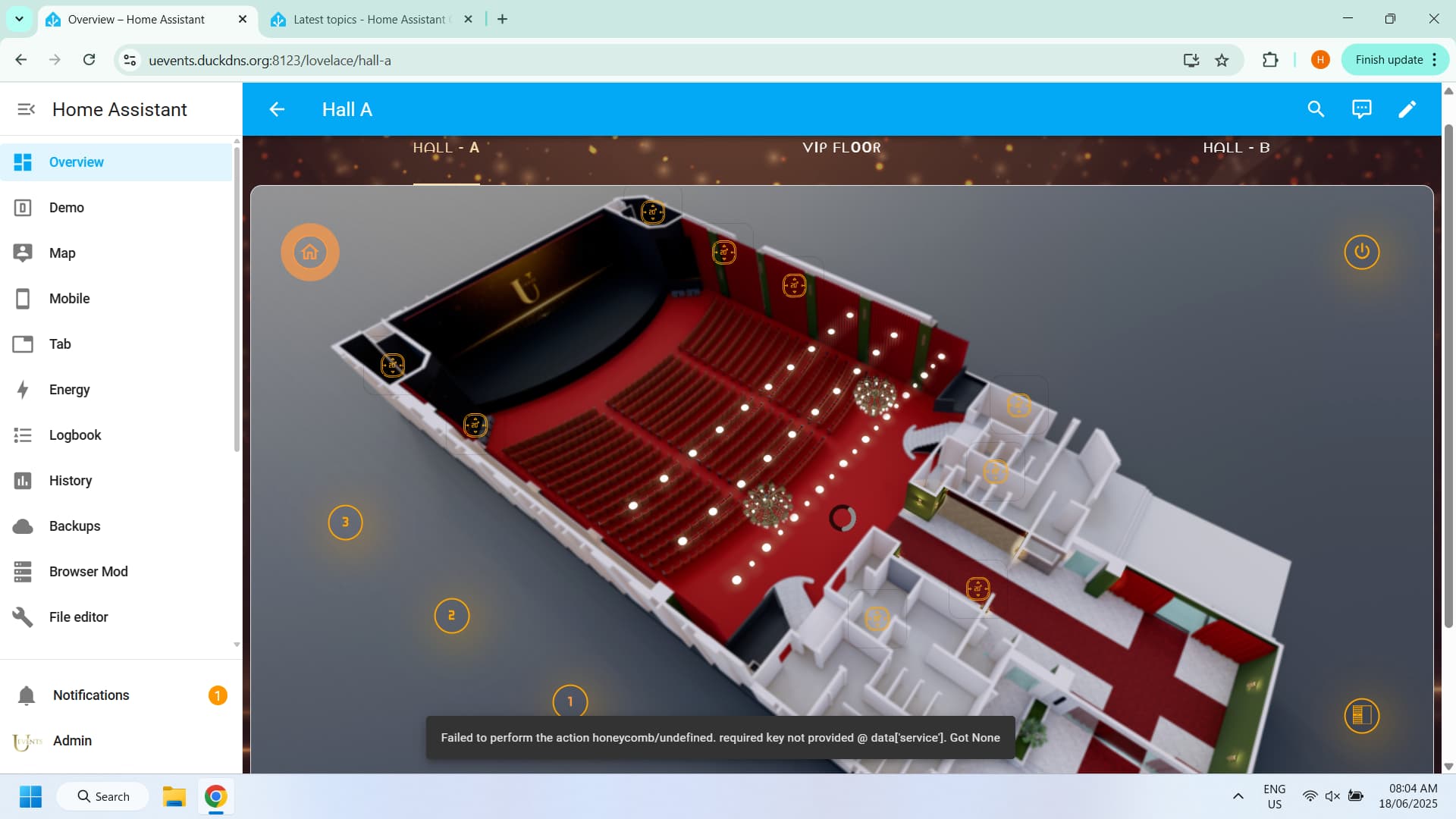

Failed to perform the action honeycomb/undefined. required key not provided @ data['service']. Got None
Hi everyone,
I’m facing an issue with the tap_action: action: call-service service: honeycomb service_data: in Home Assistant.
Whenever I tap a button meant to trigger a service call inside the honeycomb menu, I get the following error message:

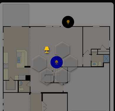

I assume you have installed Honeycomb and have confirmed it’s working?
Please provide the complete configuration YAML, correctly-formatted with the </> button, for the button that is giving the issue. Your post should look something like this example from the guide:

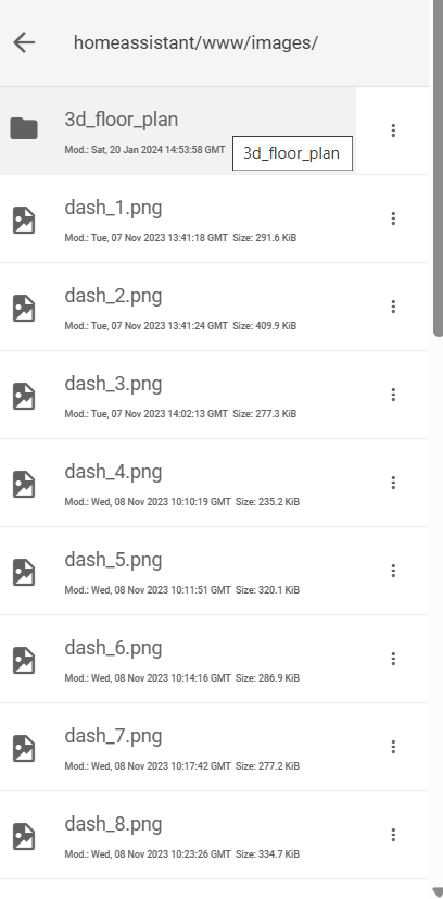

            - type: picture-elements
              image: /local/images/3d_floor_plan/hall_a/base.png
              elements:
                - type: image
                  entity: light.main_sliding_door_lights_cove_light
                  style:
                    top: 50%
                    left: 50%
                    width: 100%
                  state_image:
                    "on": >-
                      /local/images/3d_floor_plan/hall_a/entrance_cove_lights.png
                    "off": /local/images/3d_floor_plan/transparent.png

                  tap_action:
                    service: honeycomb
                    service_data:
                      autoclose: false
                      active: true
                      spacing: 2
                      buttons:
                        - list [0]: skip
                        - icon: mdi:view-dashboard
                          color: rgb(255, 152, 67)
                          show: true
                          autoclose: true
                          color_type: card
                          style:
                            icon:
                              - width: 10%
                          tap_action:
                            action: navigate
                            navigation_path: /lovelace/dashboard
                        - icon: phu:bulb-lightguide-flask
                          show: true
                          autoclose: true
                          color_type: card
                          style:
                            width: 1%
                          tap_action:
                            action: navigate
                            navigation_path: /lovelace/lights
                        - icon: phu:thermostat-v2
                          show: true
                          autoclose: true
                          color_type: card
                          style:
                            width: 1%
                          tap_action:
                            action: navigate
                            navigation_path: /lovelace/thermostat
                        - list [4]: break
                        - list [5]: break
                - type: custom:button-card
                  icon: mdi:power
                  color: orange
                  color_type: icon
                  aspect_ratio: 1/1
                  styles:
                    card:
                      - "--mdc-ripple-color": orange
                      - "--mdc-ripple-press-opacity": 0.6
                      - border-radius: 50px
                      - border: solid 2px orange
                      - box-shadow: none
                      - padding: 0px 0px
                      - margin: 0px 0px
                      - box-shadow: 6px 7px 50px -4px orange
                      - background-color: var(--card-background-off)
                    icon:
                      - margin-bottom: 5%
                      - width: 70%
                  style:
                    top: 10%
                    right: 3%
                    width: 3%
Are all your referenced images located in a folder in the www?
/local/images/ = www/images/ when using a file editor
YES

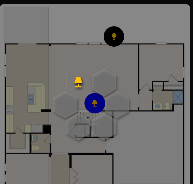

Test this format
entity: light.night_stand
tap_action:
  action: fire-dom-event
  honeycomb_menu:
    buttons:
      - icon: mdi:lamp
        position: 0
        show: true
        active: "[[[ return entity.state != \"off\" ]]]"
        tap_action:
          service: light.toggle
          service_data:
            entity_id: entity
An easier method is to template described here
Something like this when using the picture element card
elements:
    icon: mdi:lamp
    show_name: false
    styles:
      card:
        - background: blue
        - width: 50px
        - height: 50px
        - border-radius: 50%
    style:
      top: 50%
      left: 50%
      width: 20%
      height: 20%
    tap_action:
      honeycomb_menu:
        buttons:
          - icon: mdi:lamp
            position: 0
            show: true
            tap_action:
              service_data:
                entity_id: entity
    show_name: false
    styles:
      card:
        - background: black
        - width: 50px
        - height: 50px
    style:
      top: 20%
      left: 60%
      width: 20%
      height: 20%
    tap_action:
      honeycomb_menu:
        buttons:
          - icon: mdi:lamp
            position: 0
            show: true
            tap_action:
              service_data:
                entity_id: entity
image: https://demo.home-assistant.io/stub_config/floorplan.png
