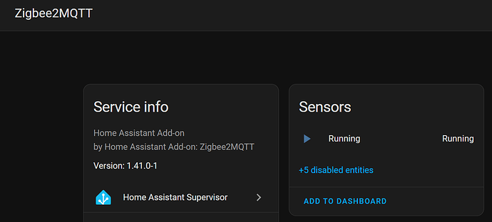

In HA, go to Settings > Devices & Services > Devices tab. Search for Zigbee2MQTT. It’ll take you to the “device” page for your z2m addon.
Under the “sensors” panel, you should see an entity named binary_sensor.zigbee2mqtt_running (if it’s not there, click the “+6 disabled entities” under the sensors panel).
That will give you a binary sensor which you can automate to send a notification to you when its state is off.
