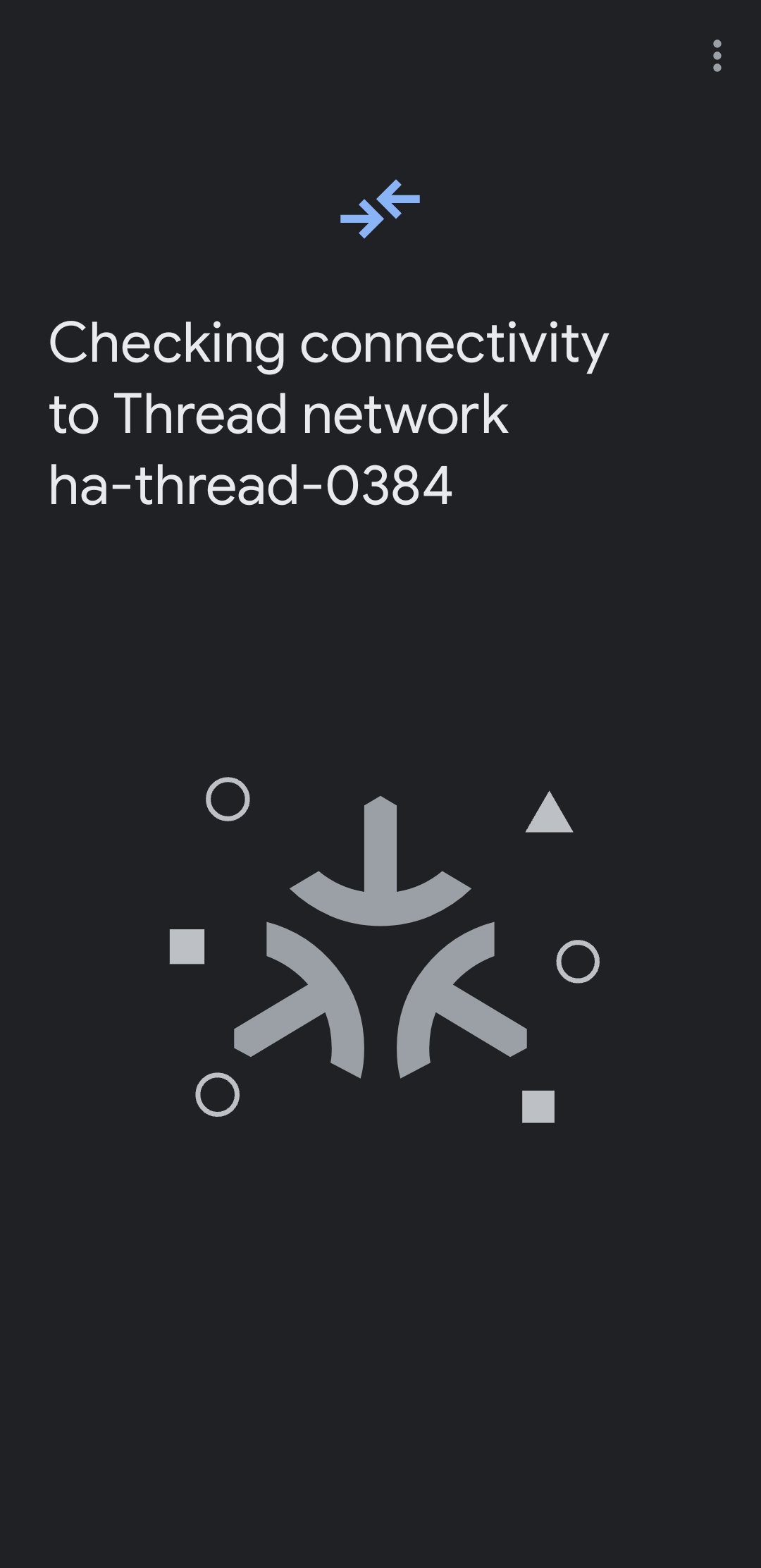

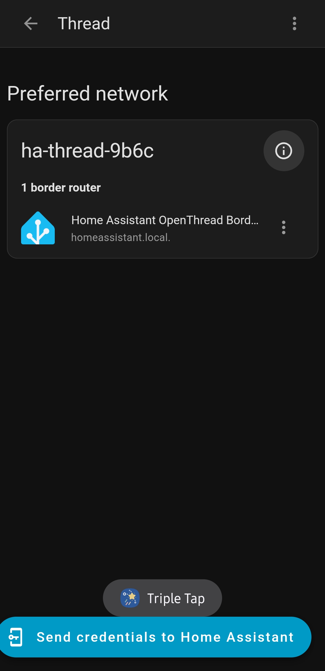

I’m trying to add Aqara U200 Smartlock device to HA, and I do it via Google Home.
What I see is that in HA I have a different Thread network name than what Google Home sees. Why is that?

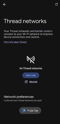

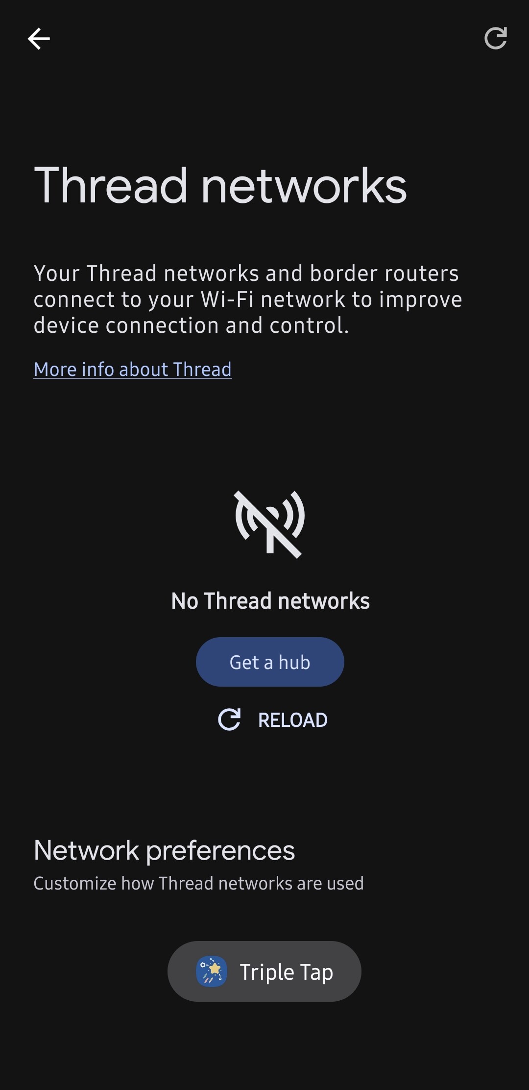

I also see this on my phone:
Bottom line is I’m unable to add this device.
