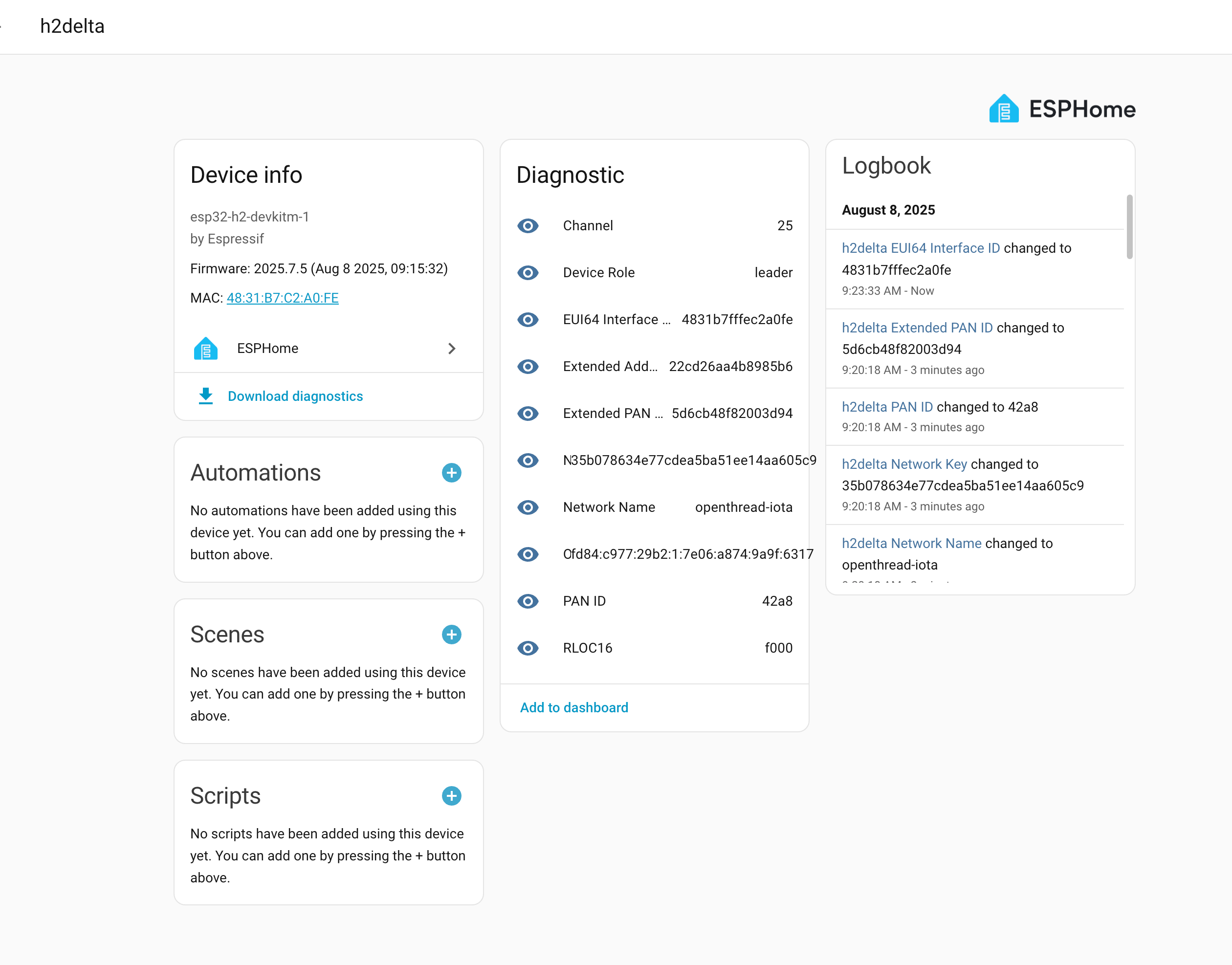

and applying via esphome run h2gamma.yaml, I was able to see the device being autodiscovered by the ESPHome in homeassistant and I could one-click add it:

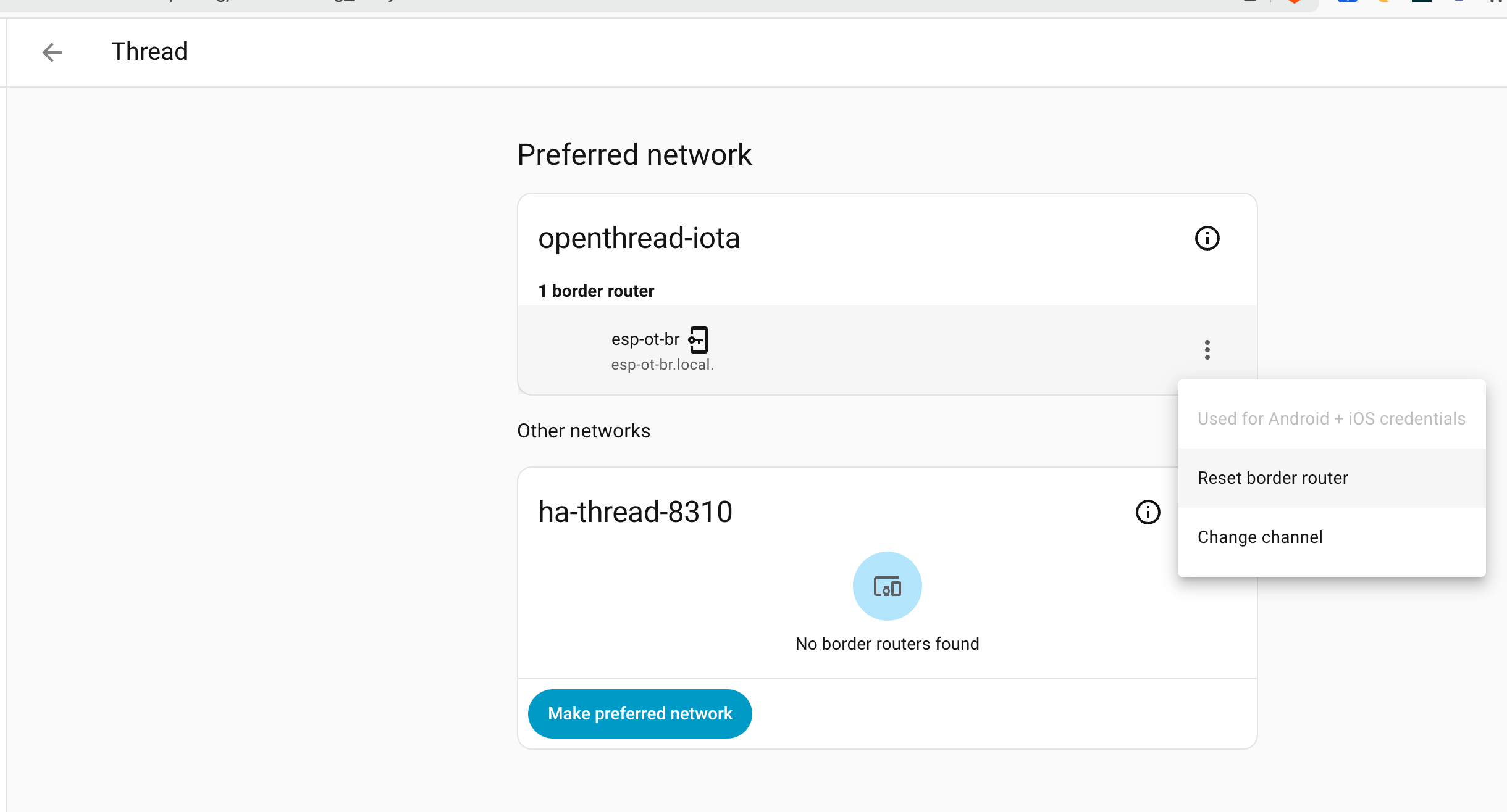

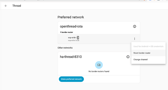

A note for my futureself. thread/esphome doesn’t like changing names. I had three boards that I was frantically switching and they got the same hostname - the problem is that the hostname is probably partly cached on the border router level, so when I flashed boardA with h2alpha name and it connected (but I did not add it), and then I flashed boardB with the same config and therefore same h2alpha hostname, esphome gets confused and will show “Unable to add/connect” because the name is associated with the old ipv6 address (I think). Similarly, I couldn’t change hostname if I wanted to change it. The solution I found out (with a minor heartattack as I thought I factory-reset my border router) I could go to Reset Router:
It disappears for a second, then appears under “Other networks”, but you can click again on “Add to preferred network” - the network settings are the same, fortunately.
After this procedure, I was able to “reregister” new hostnames fine.
However, one particularly stuborn device was still showing with wrong name, and I couldn’t add it. I flashed the device again with a new name, used http://esp-ot-br.local/topology to figure out it’s IP address, click on “Add device”, and manually changed the IPV6 address as the one there was wrong with my new from /topology and tada it worked (it even fetched the correct name after adding it)

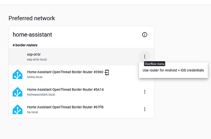

And to get the network status on http://esp-ot-br.local/index.html#Status, you need to click on “OverView” → it then fetches the data and you see the details instead of just “Unknown”

I must say, I don’t have the ‘reset border router’, but I think it would be a problem for the other border routers

I did manage to get it working, here
