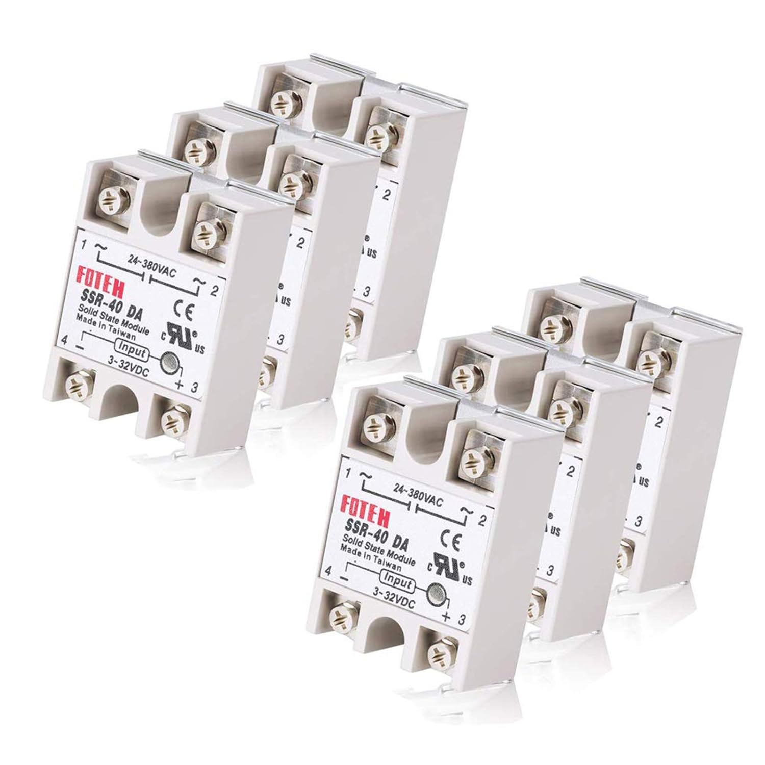

I have an improvement to my ‘fix’. I sent a picture of my hack to my friend. He suggested that I put a 1/2" (12.5 mm) piece of foam between the antenna and the metal. While adding the metal helps change the signal from omni to uni directional, it also effectively shorts the antenna by reducing the impedance. He showed a graph of impedance vs. wavelength. Max impedance is reached at about 30% wavelength. For 2.4 GHz Wifi, that 30% is about 1.5" (38 mm). However, there is still the wave shaping to consider. It is a compromise between the 2. I added some foam and improved the signal again. While it had been better than before AND the uptime graph didn’t show any ‘unavailable’ occurrences (over only a couple of days), it did bounce around and wasn’t as good as I hoped. Now that I have included the foam, the signal is again much better. I discovered a way in HA to download the data as a CSV and have included a few of the data points. The first few data points are before the foam, the -85 is probably when I actually was making the change, the rest are after. It is a nice improvement. I will make a standalone post of this to hopefully help others searching for Shelly uni signal issues.
