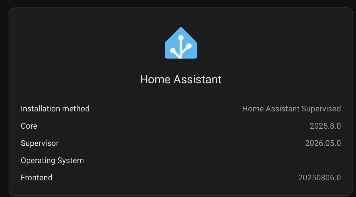

  • Installation: Home Assistant Supervised via Docker
  • Supervisor: 2026.05.0
  • Core: Stuck at 2025.8.0 (attempting to upgrade to 2026.5.3)
  • Stability: This setup has run flawlessly for ~3 years with zero upgrade issues until this version jump 2 days ago.

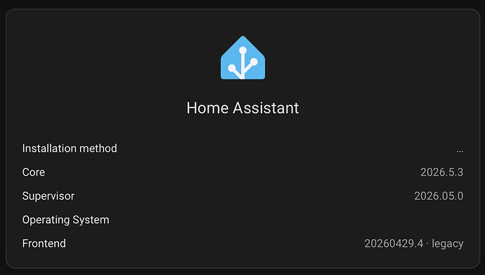

The Supervisor automatically rolls back the Core update exactly ~10 minutes after starting the new container. The Core actually starts successfully, and the UI is fully accessible on
the new version.
