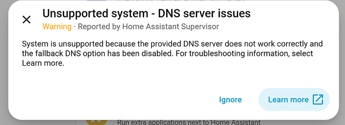

I've been running HAOS inside a proxmox VM for a few years now, and just yesterday I got this notification:
I have two bind9 DNS servers at home. Both are working perfectly fine. I entered HAOS shell and did some nslookups against both of my DNS servers and both are responding as expected on both IPv4 and IPv6.
Yes, I did disable 'fallback' DNS ages ago, that's intentional.
Any idea why am I suddenly getting these messages?
